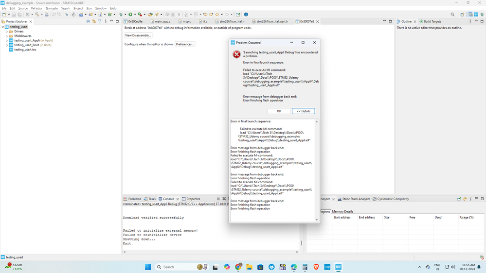

‎2024-12-09 10:52 PM
Hello alister,
Greetings from pooja.
I am working on the USART exercise as per your suggestion using the NUCLEO-H7S3L8 board with STM32CubeIDE. I'm facing a similar issue. As suggested earlier, I updated the debug configuration to write my application code to an external loader for storing it in external flash. However, I am encountering an error: "Failed to initialize the external memory," and the reset option is also not functioning. I would greatly appreciate any assistance in resolving this issue.
Thank you!
‎2024-12-10 4:34 PM
This isn't what halfordC's posted about and should be a new thread.
Not reading 1MAIN_APP.C because I'm guessing the problem's occurred before the app executes.
I don't know why your app's debug configuration's external loader (uses STM32CubeProgrammer) is failing.
https://wiki.st.com/stm32mcu/wiki/Getting_started_with_External_memory_Manager_and_External_memory_loader and other places describe the following:
- Building and loading the boot code to internal flash that either executes the app in place (XIP) from external flash or copies it from external flash to external RAM and executes it in place there (XIP).
- Building and loading the app to execute from external flash or from external RAM.
