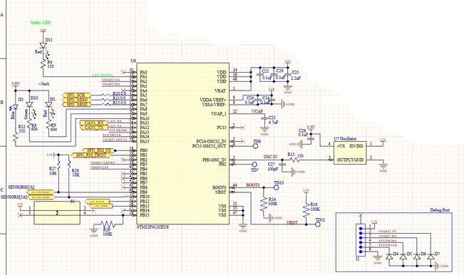

Hi , I am also making custom board for GPS, and same issue I am facing, unable to connect via SWD, Please help to debug.

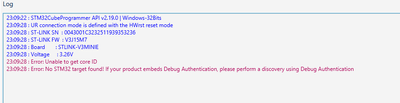

How are you trying to connect and how, exactly, is it failing? Show logs & screenshots.
Ans: Connected ST-Link v3 SWDIO to MCU SWDIO and CLK to CLK, and GND and VCC from MCU Board.
ST-Link Log

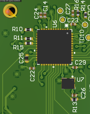

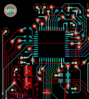

Traces and Component Placement :
Red is top layer and Blue is Bottom layer

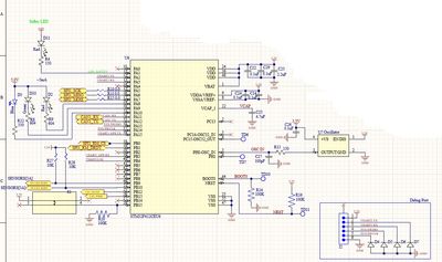

Schematic:

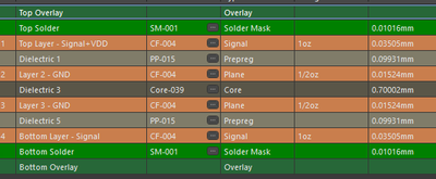

Board Stackup:
Also maintaned impedance for signal = 50 and for CAN=120

You don't have NRST on your debug header; Have you tried adding that, and then connecting under hardware reset?
Ans: Yes I tired MCU NRST(Pull High SCH - test point TD11) Joining directly to ST-Link RST pin and even by MCU NRST (pull low joing -SCH test point TD11 to GND )
