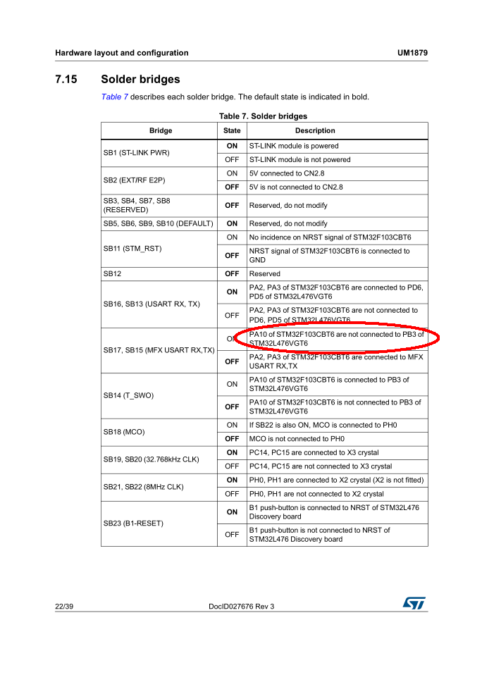

[UM1879 32L476GDISCOVERY manual] jumpers table
waclawek.jan
Posted on February 25, 2018 at 14:30
Obviously a copy-paste error.
Imen.D
Posted on May 22, 2018 at 13:05
We confirm that this line in the table 7 of UM1879 Rev 3 is not correct.
It will be corrected in next revision of the document as followed:
SB17, SB15 (MFX USART RX,TX)
ON
PA2, PA3 of STM32F103CBT6 are connected to MFX USART RX,TX
OFF
PA2, PA3 of STM32F103CBT6 are not connected to MFX USART RX,TX
Best Regards,
Imen
Thanks
Imen

Imen.D
Posted on March 16, 2018 at 16:50
Hello
Waclawek.Jan
This typos is raised internally.
Thanks
Imen

Imen.D
ON
OFF
Best Regards,
Imen
Thanks
Imen
Posted on May 22, 2018 at 14:58
Imen,
thanks.
May I ask you to forward to the documentation team also my request to arrange in all DISCO UMs the pinout table in the way it is done now in the 'F4DISCO's UM1472rev.6, i.e. for each pin having listed its alternative functions (including analog and other non-matrix), pin number on the chip used on the DISCO, function on DISCO, position on any DISCO connector, and any SB or jumper relevant to that pin.
Thanks again,
Jan
Posted on July 02, 2018 at 21:11
I see UM1879 is in rev.4 now, with the correction as above.
Pity a complete pinout table (as in the F4 DISCO, as I mentioned above) did not make it into UM1879.
