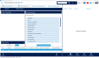

I'm trying to run a simple UCPD SINK application on the NUCLEO-U575ZI-Q.
I attempted to follow the example provided here:
https://wiki.stmicroelectronics.cn/stm32mcu/wiki/STM32StepByStep:Getting_started_with_USB-Power_Delivery_Sink#-5BOPTIONAL-5D_Configure_Tracer_for_debug
With debug setup and everything:
If I allow the application to remain a FreeRTOS application the device does not at all get recognized in STM32CubeMonitor-UCPD.

I can connect to the device but I get no trace visibility:
And I cannot communicate:
And I am running in debug mode I see that I'm infinitely in the `USBPD_DPM_Run();` function. Not sure I am doing wrong here?

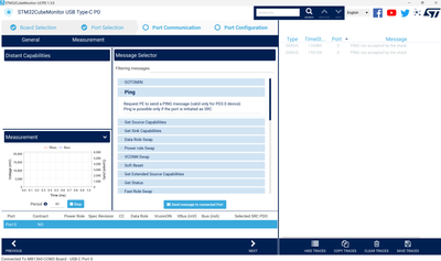

Interestingly enough I tried to follow the example given in the step by step guide above with the exact board mentioned above and I still do not get any traces:
I don't believe I missed any steps. Let me know how I can upload the sample code (since .zip uploads are not permitted)

Hello @acipriano.
For me the trace is working. You can see on the right side "Ping not accepted by the stack". And this means two things : first that the transmission from the UCPD monitor to the board is ok (kind of acknowledge that the board received the command from the PC) and second that the message was decoded correctly, back to the reception of the message on the PC. So it works in both direction.
Now : what kind of messages were you expecting in the trace ? Did you connect something on type C ?
One other question : Why wasn't the FreeRTOS application running ?

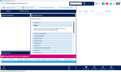

Hey Nicolas,
Thanks for your reply! I guess I might be conflating 2 different things. Let's ignore the FreeRTOS issue for now.
I am currently able to communicate with STM32CubeMonitorUCPD but I guess I'm not sure how to use it to debug anything at all seeing that all the responses to any requests are rejections by the stack!

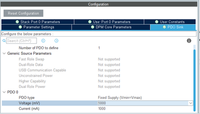

Next, I have my UCPD set up to increase the voltage from 5V to 9V
But I'm still reading 5V and I am not sure how to debug this issue.

Hello @acipriano,
You didn't answer to my first question : did you plug two devices together ?

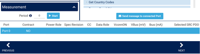

Did you reach explicit contract ? (On, the picture you shared on the ‎2024-04-17 09:59 AM, we see "Contract : NO")
On the bottom lines of UCPD monitor, as on the picture below (here it is a G0-Eval board with port 1 and port 2 looped) we should see this status :
Only if you have two devices connected, you will see protocol exchanges.
As you can see on the trace side, we see messages going out (orange) and going in (green). And every time we get a GoodCRC acknowledge.
For a sink, you need to adapt the PDO request depending on the source capabilities. Have a look at this wiki chapter. You will find links to code examples. Adding PDOs in the UCPD monitor configuration will not trigger automatic voltages request. You need to establish your own strategy in the embedded application.
Getting answers like "not accepted by the stack" means most of the time that you didn't respect the right protocol sequence.

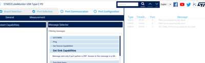

Don't you even get a trace message like "USBPD_CAD_STATE_DETACHED" at reset when you use UCPD monitor using just the tracer part (on the right side, pointing to the COM port manually in the dark blue "Select Tracer Port" drop down list, not by clicking on the board selection tab) ?
For me it seems that you have no scheduling of the CAD task. (The CAble Detection part)

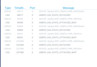

Hey Nicolas,
Thanks for pointing me in the right direction. I'm now getting USBPD CAD messages:
And yes, I'm reading the 5V signal from an oscilloscope and have tried plugging the USBC to my computer and to the wireless charger.
I'm also getting the UCPD interrupts if I attach or detach the USBC cable from my computer.
I managed to adapt the G0 example to get the FreeRTOS to work.
I still can't get the contract to work still. Any further insight into what this might be caused by?
Thanks
Amilcar
Hello Amilcar.
Looks better.
However I doubt that the STM32 gets the good VBUS level thanks to the ADC measurement.
Are you starting ADC measurements on VBUS_SENSE pin PC2 ? (See for example BSP_USBPD_PWR_VBUSInit)
Can you try to print the VBUS level thanks to the user button and the code described in the Wiki here ?
What value is returned by BSP_USBPD_PWR_VBUSGetVoltage ?
Because I see some debug messages in your trace that would indicate some code is missing.
Whenever you have "ADVICE: Update xxx" it means that you have to fill in this part of code. (And of course, once filled, you can remove the ADVICE print...)
What is the value of the dead battery pin PB5 (UCPD_DBn) ? (see again the wiki for G0, but you need to adapt it for U5)
