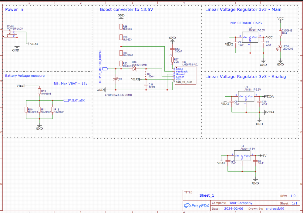

I have a custom PCB which has an CH340C (U7) serial chip and a USB-C (U1) port. See wiring diagram:

Thank you for your reply @Andrew Neil .
I see, then the fault must be in the driver or someting hardware. I have however measured the connections between the STM32 (RX/TX) and the serial chip (CH340C).
The VCC power suply comes from a linear voltage Regulator 3v3 (U2). See wiring diagram.
Any tips for the CH340C?
Your problem is in CH430C, or between it and the PC - not between the CH430C and STM32.
Nothing specific.
Are you sure it's genuine & working?
Check carefully that it's correctly oriented, all joints are good, no shorts, etc.
Do you have a known-working CH430C to compare against?
The STM32F405RGT6 has USB - why not use that?
