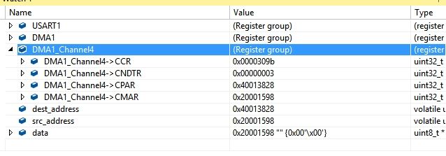

I am having trouble trying to get the UART transmitter to work with the DMA controller. The UART transmitter works fine when I do a single transmission by manually updating the TDR. But, when I use the DMA controller, the data that is transmitted is not what is expected.
It appears to me that the data being sent is coming from a memory address other than the address that I have told the DMA controller to point to in CMAR. But, when looking at the address of the data and the address in the CMAR, it matches. So, I am not sure what the problem is but I do wonder if the problem is something I am not understanding with C and C++. Since VisualGDB operates in C++ files, I write C++ wrappers for the C functions that do the heavy lifting with modifying the registers. When, I tried using a data pointer for the memory address to read from that was compiled under the C compiler, I could not get the DMA controller to operate correctly. When I pass the DMA controller a memory address from a pointer that was compiled under the C++ compiler, it works but sends the wrong data.
Hopefully, someone can help me.

And here is what the debug shows when stopped at the end of this setup function:

waclawek.jan
Posted on January 10, 2017 at 06:05
Edit: compilable example code posted below in comments. The problem now with this code is that too many messages are being sent in addition to the wrong data being sent.
I don't see anything wrong in the code.
I wouldn't enable DMA if DMA_setup() since you don't intend to transmit at that point.
And I definitively wouldn't OR in
DMA1_Channel4->CNDTR |= (uint16_t)0x03;
in DMA_transmit(),
But IMO neither of these grant described symptoms.
Can't this be UART-related issue anyway, such as baudrate mismatch problem, or problematic transmission circuitry (ground fault for example)? You could try to transmit a similar (but not the same to be distinguishable) message 'manually' by polling, in the same program, before starting DMA.
Also, I am no C++ expert. From C standpoint the play with tmp and src_address in DMA_setup() is unnecessary,
src_address = (uint32_t)data;
should work the same; again, this should not be source of described problems.
Also, I'd try with a static/global data buffer, rather than put it on heap (can't heap collide with stack?)
Posted on January 10, 2017 at 22:10
Hey Jan,
Big thanks for looking into this for me. I was able to get everything working. It turns out that the correct data was being sent, I was just not interpreting it correctly in the logic analyzer. One of the problems, as you guessed, was a misconfiguration in the UART. I did not enable 'send MSB first' which is what the MIDI protocol on the logic analyzer was expecting. I retried my code but used 1, 2, 4 on the data to be sent and noticed the correct high-low on the data stream but saw that it was 'backwards'.
Between that and moving the code for declaring the pointer to the data stream in the C++ portion of the code, everything is working now.
