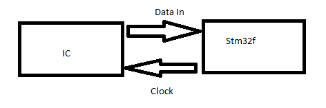

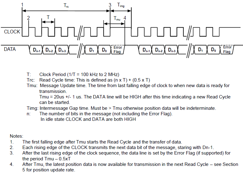

I should read output data from an IC with SPI protocol as shown below.Actually I've got confused how can read each bits with SPI for (n=16 to 32). Or can we another simple approach to read data?
I did some settings but I know it is completely wrong to read these bits because most of the time clock is available and not when I need to read.

SPI_InitStructure.SPI_Direction = SPI_Direction_1Line_Rx;
Don't use the halfduplex Rx-Only mode. Use the normal fullduplex mode - you don't need to assign a MOSI pin and it still will work. Then, simply transmit+receive 4 bytes or 2 halfwords.

Actually I access only to output data-pin (because the chip sends only data and don't receive anythings) 0690X00000605z4QAA.png
I changed my normal full-duplex mode and write this program , but I get p[0]=227 or 160 and p[1]=0 always ( in 16bit that is wrong value when the IC change it's value)

I guess this is the time when you should connect an oscilloscope or a logic analyzer.
Posted on January 10, 2017 at 20:17
Thanks waclawek.jan for your suggestion.
I've seen that my IC works fine when I set SPI data size to 16b.However my main problem is that in this code , I am able to read the first two bytes and when I want to read the next two byte it return again the two first bytes.(it seems that clock stop for a little time (when I want to get p[1] value)and the IC thinks it is a new connection) and I get p[0] is equal to p[1].

How can solve this states?
Posted on January 10, 2017 at 20:57
Something like this:
