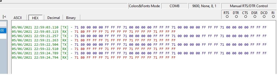

I'm using STM32F103C8T6 processor with an 8MHz internal clock, 9600 baud rate, 8bit + 1stop bit and no parity. For receiving uart data, I'm using a global interrupt.
While I'm receiving data with usart1 or usart2, I can not receive null bytes. Now I already try to turn off all other peripheries. I'm did not help. I also turn on internal pullups on usart2 to test if that was a problem. The end result was negative.
My global usart1 handler is very simple. Every byte that I receive, is sent back to the computer with usart1.

Picture below is showing send data to MCU with blue color and received data back to the computer with red color. The null bytes are missing.
What can I do.

What does Send_data_userP do? Note that you should be using separate TX and RX buffers, but probably doesn't affect anything if you're doing 1 character at a time at low rates.

The "Send_data_userP" is just data transmit with selected usart.
void Send_data_userP(UART_HandleTypeDef *huart, char *string)
	//---Send_data---//
	HAL_UART_Transmit(huart,(uint8_t *) string, strlen((const char *)string), 2000); // transmit in blocking mode
If the first character is 0, strlen((const char *)string) is 0, so you're not sending any bytes.
Note that this would have been caught had you been monitoring the return status from HAL_UART_Transmit.
https://github.com/STMicroelectronics/STM32CubeF1/blob/f5aaa9b45492d70585ade1dac4d1e33d5531c171/Drivers/STM32F1xx_HAL_Driver/Src/stm32f1xx_hal_uart.c#L1038
BJako.1
OK so now I add HAL_Uart_transmit directly to the usart1 global interrupt handler. Is a little better but there are still some bytes missing.

Since HAL_UART_Transmit blocks, the system isn't ready to receive the next byte by the time it arrives. If your incoming data has pauses between bytes, it would work okay. Blocking functions in IRQ handlers often causes issues like this.
A better method would be to store incoming data into a FIFO and send out when ready.
