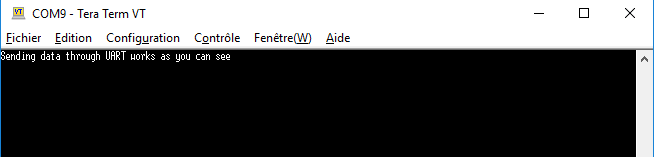

Hey guys, i'm back.
I'm trying to configure UART on STM32L0K8T6. The goal is just to send data to this MCU via TeraTerm and send data from MCU to PC.
To do so, i used CUBEmx to easily configure UART but the fact is I can send data from MCU to PC but STM32L0K8T6 doesn't receive data sent by TeraTerm.
Here is the main.c :

I never go through this function (i checked with debugger) except one time when i launch the program.
I have the same problem with a STM32F042K6T6 MCU but it works with :
--> STM32F401RE
--> STM32F030R8T6
I'm configuring UART thanks to cubeMX and i'm just using HAL functions.
Why uart isn't working for all of these projects ?

Not working with HAL_UART_Receive function either... it reaches timeout
hello,
I changed no_pull to pull_up for both RX TX but still the same.
Well, i also tried to change Sysclock (chosing HSI as in my STM32F401RE project, hope i did it well but i think so) but nothing change. I also tried to change clock and pull up/pull down state at the same time
Maybe my STM32L0K8T6 has hardware issu because it was given by another colleague and he did some strange things on it. But I do not have another board for the moment.
AJT
