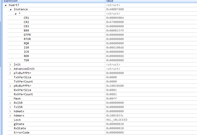

Hi, just want to know if it is possible to switch the interrupt between Character match and Each character received interrupt on the fly without stopping the UART ?
2 REPLIES 2
waclawek.jan
Which STM32?
Regardless of that, IMO yes.
STM32F7xx:

HAL_StatusTypeDef HAL_UART_Receive_IT_CC(UART_HandleTypeDef *huart, uint8_t *pData, uint16_t Size)
  /* Check that a Rx process is not already ongoing */
  if (huart->RxState == HAL_UART_STATE_READY)
    if ((pData == NULL) || (Size == 0U))
      return HAL_ERROR;
    __HAL_LOCK(huart);
    huart->pRxBuffPtr  = pData;
    huart->RxXferSize  = Size;
    huart->RxXferCount = Size;
    huart->RxISR       = NULL;
    /* Computation of UART mask to apply to RDR register */
    UART_MASK_COMPUTATION(huart);
    huart->ErrorCode = HAL_UART_ERROR_NONE;
    huart->RxState = HAL_UART_STATE_BUSY_RX;
    /* Enable the UART Error Interrupt: (Frame error, noise error, overrun error) */
    SET_BIT(huart->Instance->CR3, USART_CR3_EIE);
    /* Set the Rx ISR function pointer according to the data word length */
    if ((huart->Init.WordLength == UART_WORDLENGTH_9B) && (huart->Init.Parity == UART_PARITY_NONE))
      huart->RxISR = UART_RxISR_16BIT_CC;
    else
      huart->RxISR = UART_RxISR_8BIT_CC;
    __HAL_UNLOCK(huart);
    /* Enable the UART Parity Error interrupt and Data Register Not Empty interrupt */
    SET_BIT(huart->Instance->CR1, USART_CR1_CMIE);
    return HAL_OK;

The above code is what I use trying to switch between Character match (CC) and normal interrupt, so if the program detect 'G' it will switch to interrupt each character received. however after the switch the UART seems to not generate any interrupt anymore and overflow flag is set and here is the register:
0693W000001skFEQAY.png I thought we just need to set USART_CR1_CMIE and ADD ? am I missing something ?
