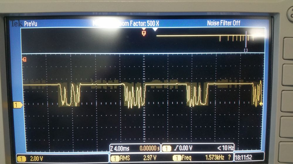

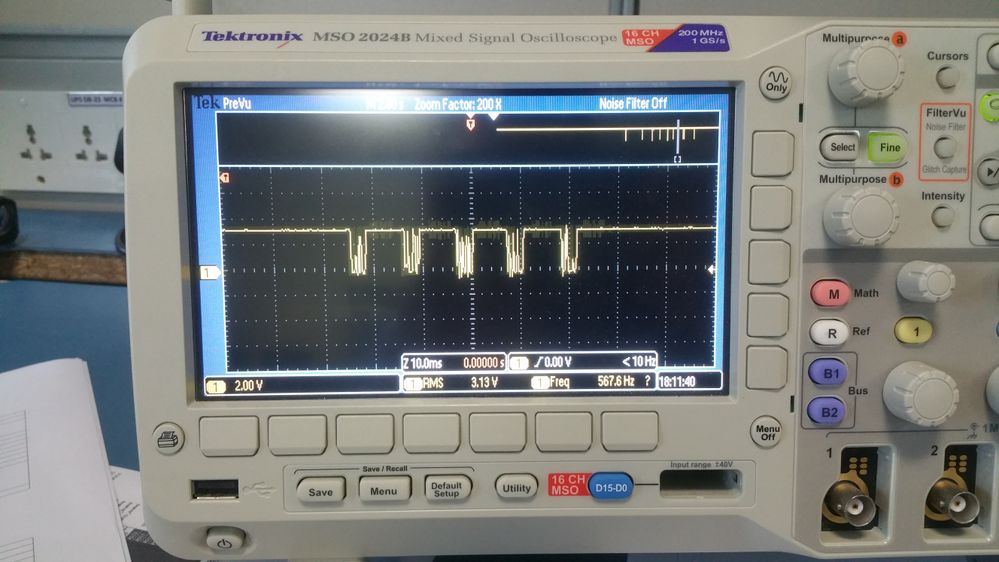

I am also attaching the UART RX signals captured on my Tektronix 200MHz DSO just for reference:

Check if the overflow or framing errors, etc are flagging at the time of failure, probably would be visiting callback in those situations.
Hope it is just the scaling on the scope, but the signals look awful.
