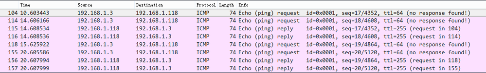

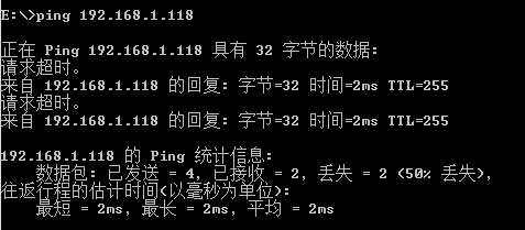

I use CubeMX 4.21.0 to generate FreeRTOS+LWIP code on STM32F746GZ Nucleo board. The problem is when I ping the board, It will reply after pinging 2 times. See below capture:
Did anybody ever meet this problem?

I traced the code and foud the problem may be in function HAL_ETH_TransmitFrame() which called by low_level_output(). I could see the ICMP pack was copied to heth buffer in memory view. But the pack didn't be sent after running function
HAL_ETH_TransmitFrame(), and will be sent after call HAL_ETH_TransmitFrame() again by another pack.
I will check DMA part of 746GZ to see where's the reason.
