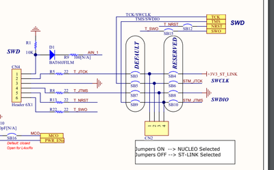

I found the solution and as you said I had to change just the UART.
Although I do have 4 questions if it's possible to get answers ? :
- A got very confused on reading the schematic of how this boards works like :

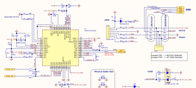

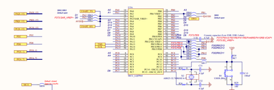

I tried to understand how UART2 works exactly which is PA2 and PA3. The thing is they are connected from the first picture to TX and RX and the D0 and D1 are disconnected. So it means I can use the ST connectors/Morpho connectors as the UART ? Without changing anything ? And what is the difference in STLK_RX and STLK_TX (isn't it that I can use any RX and TX for my STlink ?) .
- About the picture because the second picture is the same part as the first picture ? Dunno because the second picture doesn't have label of what it is.
- I don't understand what is happening here, there is TMS and JTMS and they are wierdly connected like what ?
- Last *** question does those yellow brakets like "MCO" or "RX" or "STLK_RX" are they connected to a device or is it just to say what I can connect to them ? Like "MCO" so I can connect MCO to it or "TCK on picture above" is that I can connect TCK to it ?
