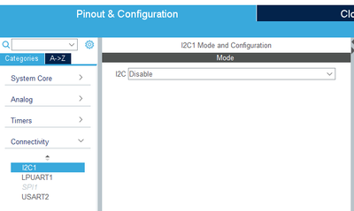

Hello @Deepu joy ,
For the STM32L031, you can use I2C / LPUART (Low-power universal asynchronous receiver transmitter) / USART(Universal synchronous/asynchronous receiver transmitter) for the connectivity .
For the first sensor you can use LPUART1 and for the second USART2.
Foued
