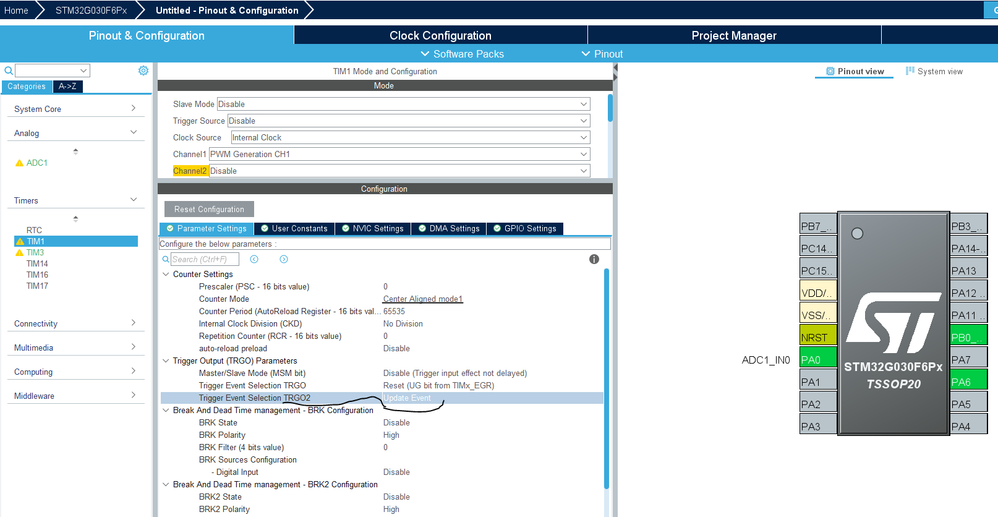

Hi @arjun.binu​ , you want the ADC to be triggered when the TIM1 update event happens.
In PWM center aligned mode , the update of TIM1 (when the counter rollsover) happpens right in the middle of the PWM.
Tell me which specific STM32G030x are you tring to use and which ADC TIM pins.

We are using STM32G030F6P6. We require ADC channels to be triggered sequentially by update event of Timer.
We tried to configure center aligned PWM mode by
1) Setting PWM generation channel mode to PWM Mode 2 (We also tried with Mode 1)
2) Setting Counter mode to Center aligned mode 1
Could you please let us know how we can properly configure center aligned PWM mode with TIM1?

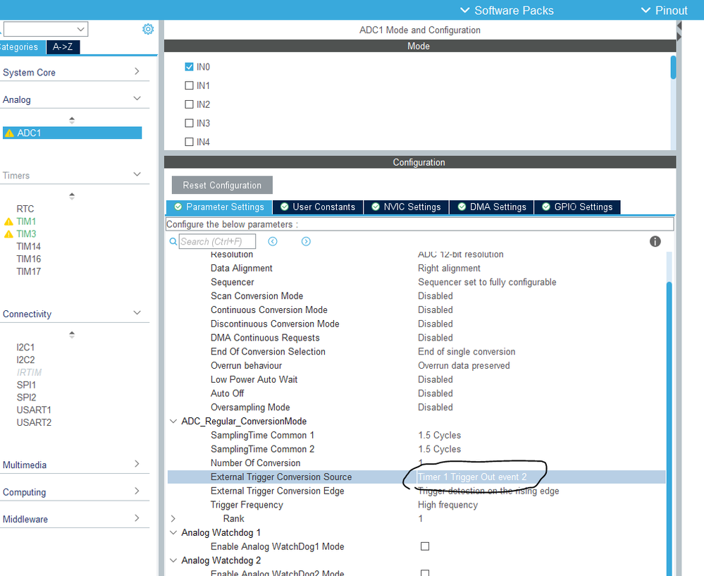

This is how you set the adc

By sequentially we meant the sequential conversion of 3 ADC channels we are using. But I guess this particular information may not be much relevant.
I dont think "sequential" means what you think.
The ADCs will be triggered at the same time, then "sequentially" stored in memory by your code or the DMA

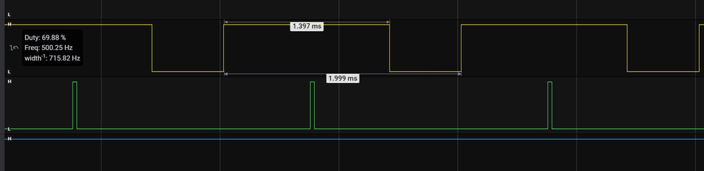

I would like to generate a center aligned similiar to the one shown below:
@Javier Muñoz​
Is it possible to generate an edge aligned PWM and a center aligned PWM no output from a single timer (TIM1)?
