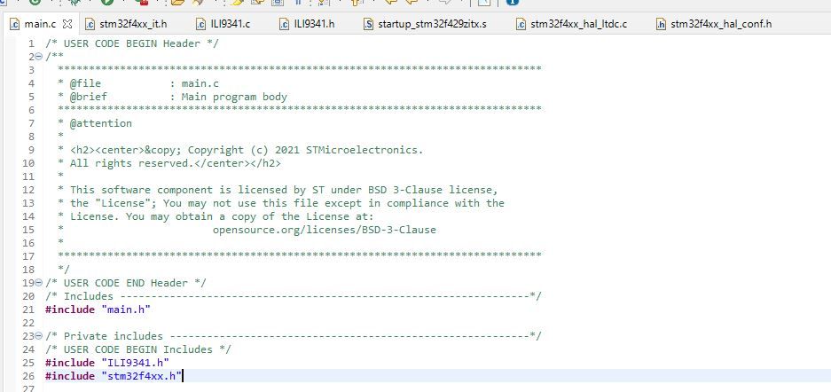

I want to create my own library.

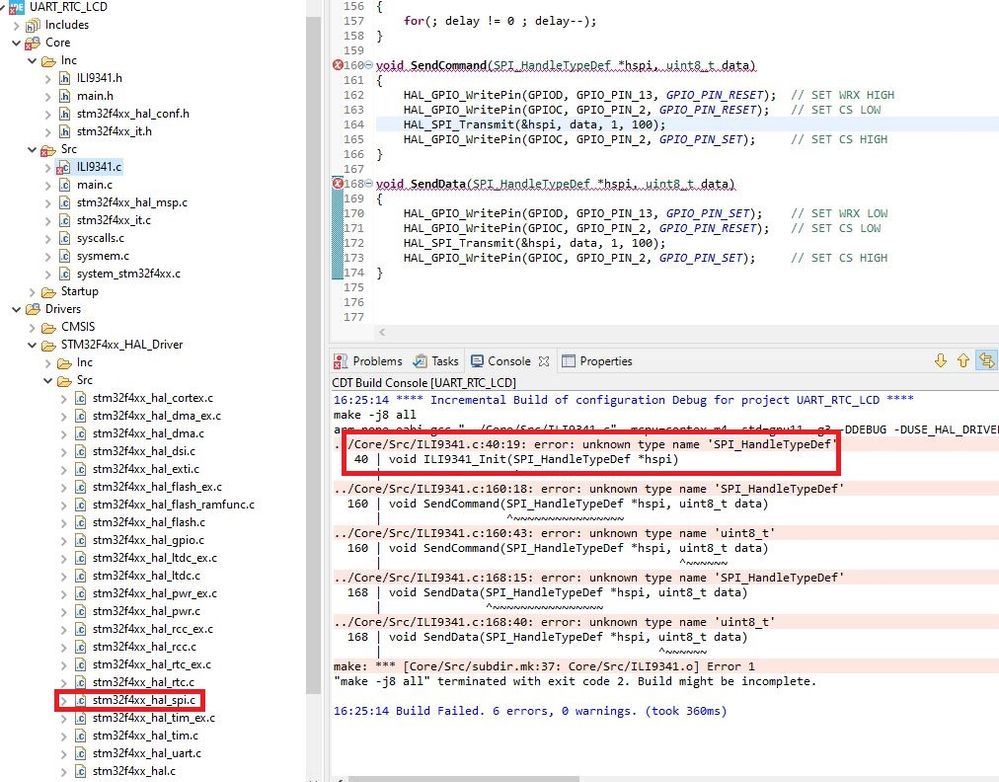

However, it seems I cannot send SPI_HandleTypedef between the main source and my library file.
My codes are not even close to the finish, but I placed in here so that maybe I have different issues that I may miss.

Every c-file needs to be compilable individually (i.e. the compiler needs to be able to find all the variable types, function signatures, ...).
So yes, wherever SPI_HandleTypedef is used, you need to include the file where that type is defined.
by including stm32f4xx_hal, you will automatically include stm32f4xx_hal_spi where the type is defined.
Typically, when creating a larger program using various interfaces, stm32f4xx_hal.h will be included in many c-files (or even in your custom header files).

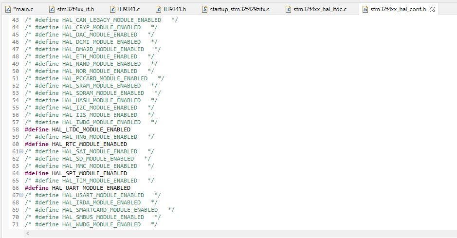

Go into stm32f4xx_hal_conf.h and ensure the SPI module is enabled.
Ensure you're including "stm32f4xx.h" before using any HAL functionality.
in stm32f4xx_hal_conf.h, SPI module was already enabled.
0693W00000D1JbjQAF.jpgI also include stm32f4xx.h header in my main, but It seems still giving errors.

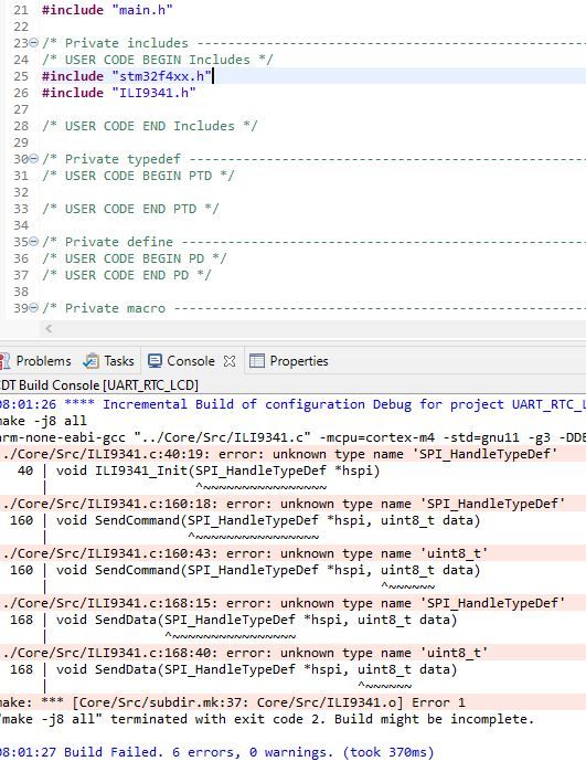

0693W00000D1JdaQAF.jpg*I am sorry I reply too late, due to the time difference.
You need to include HAL functions prior to using them.
So include stm32f4xx.h before you use them in ILI9341.h.
0693W00000D1T6WQAV.jpgthat doesn't work either.

Well actualy, even that doesn't worked.
However, when I include stm32f4xx.h file into ILI library it erases the error.
But is it the correct way to do it this way, when I also have #include "stm32f4xx.h" at main?

You're showing code in main.c but your errors are coming from ILI9341.c. Why are you marking your own posts as answering the question?
I mean, at top of the post, you suggest me to define stm32f4xx lib to before ILI9341 lib right? Did I misunderstood?
Anyway, the solution was, as both me and Sebastian said, when I include stm32f4xx library in ILI9341.c, it fixed.
