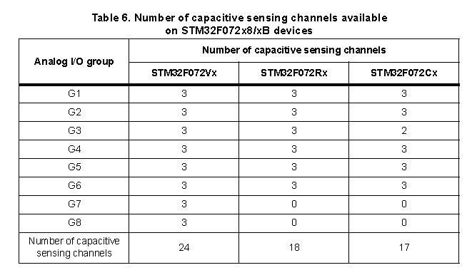

Hi
where do I see which STM32 has how many TSC channels?
In this document: UM1913 User manual: Developing applications on STM32Cube with STMTouch� touch sensing library
STM32L083VBTx is not listed!
But in STM32CubeMX i see that STM32L083VBTx has 24 TSC channels!
THX

2017-02-07 5:26 AM
You have to refer to the datasheet of the product you are using. In your case, please check the section 'Touch sensing controller (TSC)' in
.In
, you find a set of application notes that may help you to efficiently use the TSC (Ex: AN4312, AN3236...).Regarding UM1913, I'll review your feedback and come back to you to keep you informed about taken action.

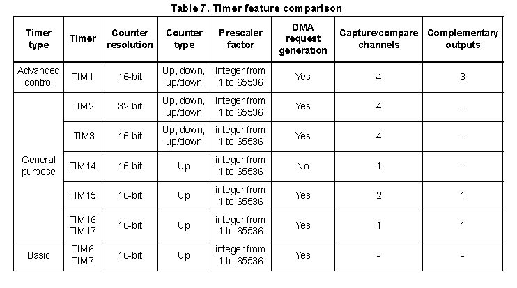

2017-02-07 9:24 AM
Not sure there is a parametric search in that form. You'll first need to determine if the parts function in the way you want.
Do the 16 PWM channels (output?) share a common frequency? Each TIM in the STM32 has a single counter element.

2017-02-07 10:14 AM
I'd review the data sheets, not looking to do part selection here. If this is a commercial project discuss with your FAE
16 PWM output channels could be achieved with 4x TIM with 4x channels. Make sure you understand the STM32 to determine if the frequency/function you want to implement can be done the way you want.

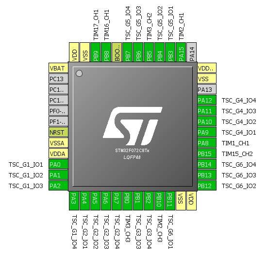

2017-02-08 10:14 PM
This is a long and time consuming process...
My recommendation is to use the CubeMx to help the selection.
The peripheral selection filter when creating a new project will help reduce the number of datasheets to read:
- select the number of timers: 4 or 6 (the STM32 often has at least 2 timers with 1 or no external channel)
- check the Touch sensing box
This should already reduce the number of documents you have to read...
At this point the datasheet will help to choose the package. It usually show the number of touch channels and the number of PWM channels
Then, you can also review the pinout in CubeMx because there is no guaranty that the PWM and touch sensing function are available simultaneously: they may share the same pin...
here an example:
