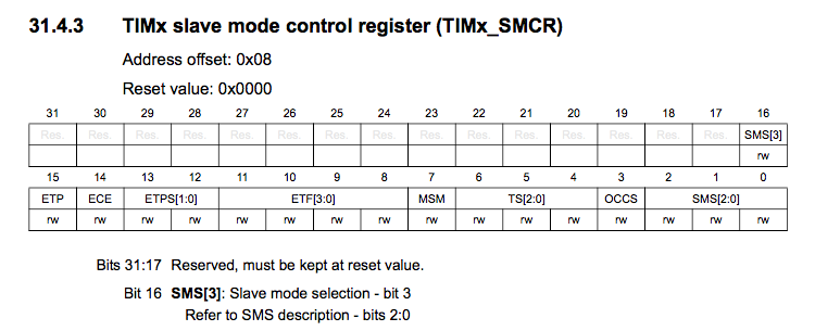

Posted on August 02, 2017 at 19:28
RM0351, section 31.4.3 slave mode control register.
chart shows SMS[2:0] but the description of SMS on page 1032 describes a 4 bit number

Dopey me. That SMS[3] is the fourth bit. They even made it easy in the header file
♯ define TIM_SMCR_SMS_Pos , , , , , , , , , (0U) , , , , , , , , , , , , , , , , , , , , , , , , , , , , , , , , , , , , , , ,  ,
♯ define TIM_SMCR_SMS_Msk , , , , , , , , , (0x10007U <,<, TIM_SMCR_SMS_Pos) , , , , , , , , , , , , , , /*!<, 0x00010007 */
♯ define TIM_SMCR_SMS , , , , , , , , , , , , , TIM_SMCR_SMS_Msk , , , , , , , , , , , , , , , , , , , , , , , , , , , , /*!<,SMS[2:0] bits (Slave mode selection) */
♯ define TIM_SMCR_SMS_0 , , , , , , , , , , , (0x00001U <,<, TIM_SMCR_SMS_Pos) , , , , , , , , , , , , , , /*!<, 0x00000001 */
♯ define TIM_SMCR_SMS_1 , , , , , , , , , , , (0x00002U <,<, TIM_SMCR_SMS_Pos) , , , , , , , , , , , , , , /*!<, 0x00000002 */
♯ define TIM_SMCR_SMS_2 , , , , , , , , , , , (0x00004U <,<, TIM_SMCR_SMS_Pos) , , , , , , , , , , , , , , /*!<, 0x00000004 */
♯ define TIM_SMCR_SMS_3 , , , , , , , , , , , (0x10000U <,<, TIM_SMCR_SMS_Pos) , , , , , , , , , , , , , , /*!<, 0x00010000 */

Btw. the same applies for TIMx_CCMRy.OCzM  - the OCzM[3] bit is further up in the same register.

A request is raised internally to add a note saying that the other bit is described as standalone in the same register.
