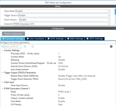

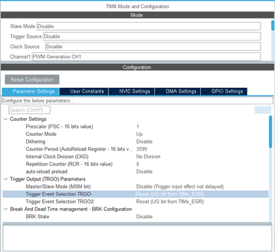

Hi everyone . I have timer problem again. I use STM32G431KBT6. I'm using timers. timer 3 for pwm pulse direction servo motor and timer 8 for pwm speed control dc motor. But when start timer8 pwm, timer 3 is starting same time. What could be the reason for this? My timers set:

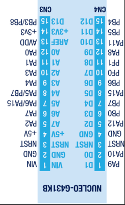

Actually I noticed something. I use nucleo card. And timer 3 is PA6 pins, timer8 is PA15. They r short circiut on nucleo board.

Either it's set up as a slave that starts when TIM8 is started, or it's getting started elsewhere, or you are misinterpreting the results.
The relevant slave settings are not shown in your screenshot.
what do you want from me exactly? I can show u. I checked my code. İt is not have problem.
Your IOC file would be helpful, or a fully compile-able program that exhibits the issue. Also would be helpful how you are determining that TIM3 starts exactly when TIM8 starts.
