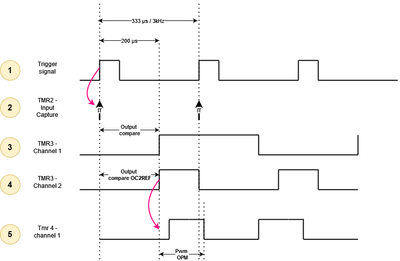

Hi
I have a trigger ( the pink trace) who triggers one delay of 200µs with the help of the timer 3 ( a channel toggles each event, the red trace) . A IT is also generated . Another channel of this timer 3 is used to trigger a one pulse mode pwm with a 100µs period and a duty cycle of 50%. This is the green trace. But I would like to have this result for each pulse of the trigger signal( pink trace) . And it' do not !!
How can I rearm this PWM? The file is attached
Thanks for your help !

Hi
here is the chronogramme
1 / it's the trigger signal
2/ it's the Input capture IT call back function
3/ it's just a signal to help in debug. It's a outpure compare who toggles the output pin
4/ another signal used to delay the pwm and another signal which is not shown on this diagram
5/ the PWM signal in one pulse mode used to control an optical device . it's triggered by Tmr3/OC2REF. This pulse can exceed the next edge of the trigger by 1µs
Thank for your help
