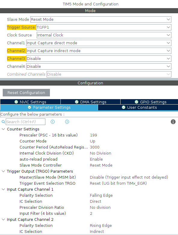

timer How to detect a signal I useSTM32CubeMX 6.6.1 and STM32CubeIDE 1.8.0 I'm using a microcontroller.stm32f103c6 I need a way to capture the signal. to calculate the speed of rotation Can someone give me some advice, thanks.

timer can capture full hi/lo pulse , just see my IR-receiver input:
0693W00000WIqQPQA1.pngi choose the timer5 clk+ prescaler, to get 1us tics; so on timer5 INT i get us count for hi and lo time of every incoming pulse.
perfect... right?

The advice was given. If you do not understand how timers work, open the reference manual and start learning!
I can't find what you told me, please guide me.
>>open the reference manual and start learning!<<
