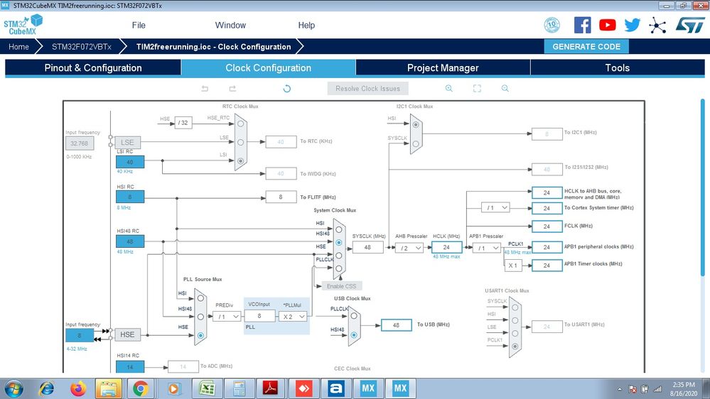

Timer 2(32 bit timer) in running mode to provide timer tick at 1ms. controller - STM32F072VB timer - TIMER 2 mode - up counting mode This timer should get TIm->CNT increment at 1 ms. then what should be the prescalar??
Bs.1
here is settings i did..but little bit confused about prescalar value

waclawek.jan
If you want TIM_CNT to increment at 1ms rate, set the prescaler to timer input clock frequency / 1000 -1. So, for example, if the system frequency is 48MHz and APB divider is 1, set the prescaler to 47999.
