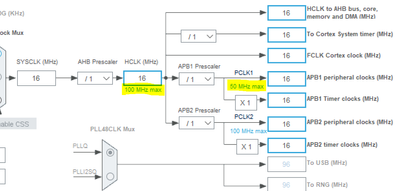

> I am new to STM32F412, how can we set APB divider to 1 or to the right value. I made a patch dividing the value by 2 but I would like to make a real fix to the problem.
The cpu clock rate is typically higher than the peripheral clock rates because they often can't run as fast as the cpu. But you can adjust your clock settings if that's what you want. Otherwise, the x2 factor isn't a bug and isn't something that needs a fix. It's how the chip works.
waclawek.jan
As TDK said above, it's not a problem, simply take it into account and make the prescaler twice as big (more precisely,  ((HAL_RCC_GetPCLK1Freq() / 1000000) * 2) - 1; ).
