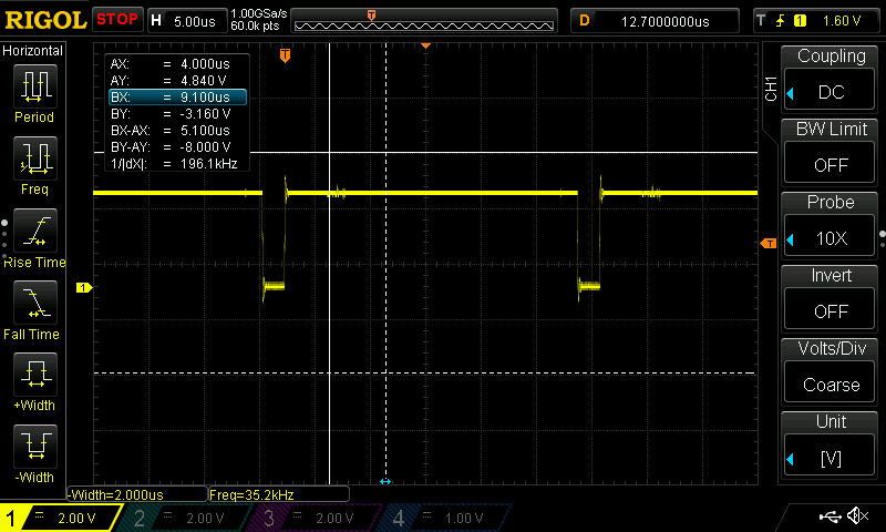

TIM4 is a master, TIM3 is a slave. Given the same values I expected their respective CCx IRQ to fire at about the same time.
Elektraglide
Set up TIM4 to generate a hsync pulse of 2us
	RCC_APB1PeriphClockCmd(RCC_APB1Periph_TIM4, ENABLE);
	TIM_Cmd(TIM4, DISABLE);
	TIM_TimeBaseInitTypeDef timerInitStructure;
	timerInitStructure.TIM_Prescaler = 0;
	timerInitStructure.TIM_CounterMode = TIM_CounterMode_Up;
	timerInitStructure.TIM_Period = LINEPULSE;
	timerInitStructure.TIM_ClockDivision = TIM_CKD_DIV1;
	timerInitStructure.TIM_RepetitionCounter = 0;
	TIM_TimeBaseInit(TIM4, &timerInitStructure);
	TIM_OCInitTypeDef outputChannelInit;
	TIM_OCStructInit(&outputChannelInit);
	outputChannelInit.TIM_OutputState = TIM_OutputState_Enable;
	outputChannelInit.TIM_OutputNState = TIM_OutputNState_Enable;
	outputChannelInit.TIM_OCPolarity = TIM_OCPolarity_Low;
	outputChannelInit.TIM_OCNPolarity = TIM_OCNPolarity_High;
	// channel 1 is hsync (active low)
	outputChannelInit.TIM_OCMode = TIM_OCMode_PWM1;
	outputChannelInit.TIM_Pulse = HSYNCPULSE;
	TIM_OC1Init(TIM4, &outputChannelInit);
Scope trace looks as expected:
0693W000007YzcbQAC.pngSet up TIM3 to be a slave to TIM4 with the same period as TIM4

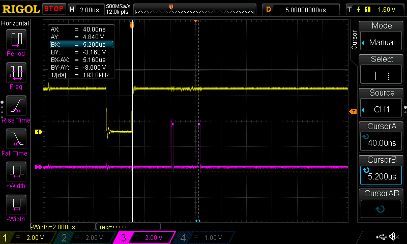

TIM3 IRQ handler toggles a GPIO line (magenta trace) on TIM_IT_Update
Q1: Why is there a delay between TIM4 Update and Tim3 Update? I expect TIM3 being a slave would be very close to when TIM4 starts a new period - ie falling edge of hsync pulse.
Now I also enable the TIM3 CC1 IRQ as well as Update IRQ and get this:
0693W000007YzclQAC.pngYou can see the CC1 IRQ gets generated a little before the Update IRQ (as expected)..but..
Q2: TIM3 CC1 has the same Pulse value as TIM4, but the IRQ is much later..I expected TIM3 to be pretty much in phase with TIM4
5 REPLIES 5
Elektraglide
[Answering my own question for anyone reading this later that find its useful]
I noticed that slave pulses were always around 30 CPU cycles later than master. Looked at the code I spotted that TIM3 was ENABLEd about 20 odd instructions before TIM4 was ENABLEd.
Enable them both at the same time and its perfect.
Doh.

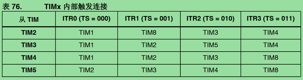

waclawek.jan
> TIM_SelectOutputTrigger(TIM4, TIM_TRGOSource_Update);
> TIM_SelectSlaveMode(TIM3, TIM_SlaveMode_Gated);
This would prevent TIM3 from running most of the time, if not entirely. "Luckily" you do this before enabling TIM3 clock, i.e. TIM3's slave-mode controller is unaffected and TIM3 runs freely.
Thanks. However, if I do not ENABLE TIM3 explicitly, setting TIM3 to TIM_SlaveMode_Trigger, I get no TIM3 IRQs at all.
I was expecting TIM4 to trigger TIM3 countup..
waclawek.jan
Read my answer carefully.
Read out the timers' register content and check.
Elektraglide
Keep getting caught out by the non-orthogonal functionality on these devices!
In this case, TIM4 triggers TIM3 not on ITR0 but only on ITR3. Found this handy map on a website (subsequently found it on p401 of RM0008)
