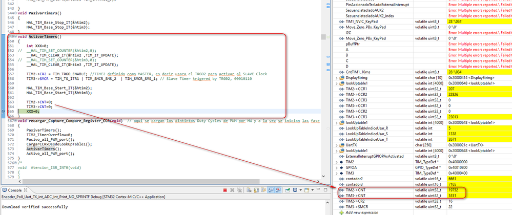

I was testing some options, but I couldn´t move forward.......In order to SYNC (as much as possible) I set Master, Slave and CNT registers in both TIMs, so after that I defined a Breakpoint in order to check if **** are same or almost the same, but CNT from TIM2 and TIM3 are not the same, there are running not tight as I expected..
I was reading RM008 14.3.20 Timer synchronization and wrote the following lines in order to set TIM2 as Master and TIM3 as Slave (as I explained above, and it is not working)
TIM2->CR2 = TIM_TRGO_ENABLE;
TIM3->SMCR = TIM_TS_ITR1 | TIM_SMCR_SMS_2 | TIM_SMCR_SMS_1;
HAL_TIM_Base_Start_IT(&htim2);
HAL_TIM_Base_Start_IT(&htim3);
TIM2->CNT=0;
TIM3->CNT=0;
TIM2 and TIM3 are defined using CUBEMX, both timers have the same configuration at this point (setup time), but later when the program is running, when the Overflow interruption on TIM2 happened, I stop timers TIM2 and TIM3, define Master and Slave and Set **** to 0 (I am setting Master and slave every time overflow happened, I know it is not ok, but as I am just testing if clocks are working together, I guess, is not a big issue,
later I will move it outside of the loop, but I did that just to see how the clock is set when Debugger is fired just after set (manually) CNT registers to 0, STM32CUBE debugger shows TIM2/3 **** values are NOT equal...Here is a small list of 4 tests (using RESSUME button in Debug mode).
1° 2° 3° 4°
TIM2_CNT 19752 19636 24790 15430
TIM3_CNT 5351 20811 17058 7503
diff 14401 -1175 7732 7927
The value of **** shows me that TIM2 and TIM3 are not working in SYNC mode.... test N°2 show that TIM2 CNT is = 19636 and TIM3 CNT = 20811, when TIM2 CNT is set to Zero before TIM3 CNT....I know, Timers are not set correctly,

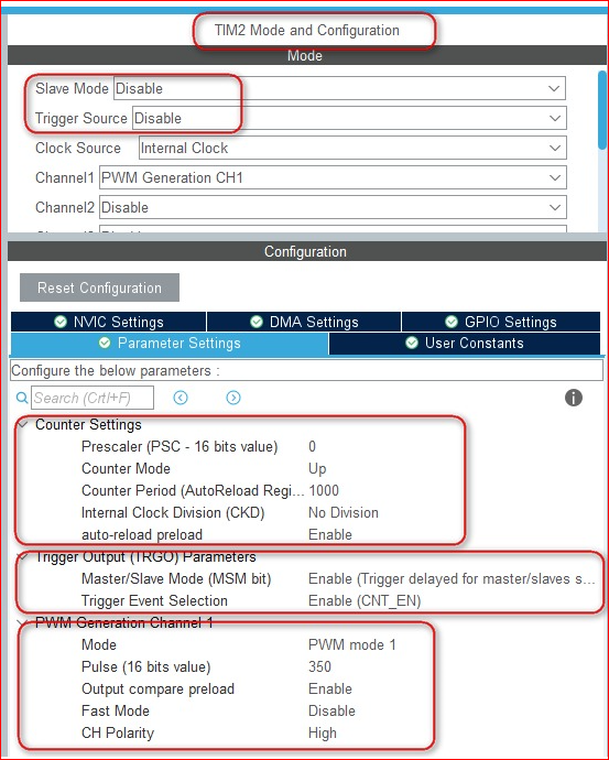

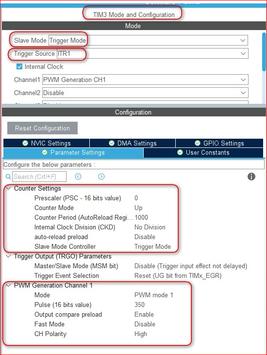

Finally TIM2 is working as Mater and TIM3 as Slave in STM32F103C8.
Here is the setup in both timers...
TIM2 as Master:
TIM3 as Slave:

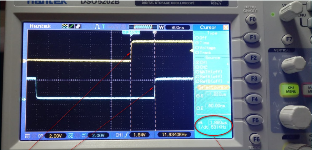

This picture was taken when TIM2 and TIM3 were not working as master/Slave:

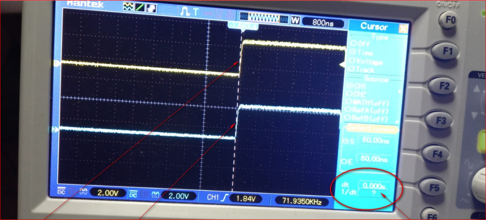

And now, when TIM2 and TIM3 started to work as master Slave (Slave in TRIGGERED Mode)
Thank alot for youe help.
