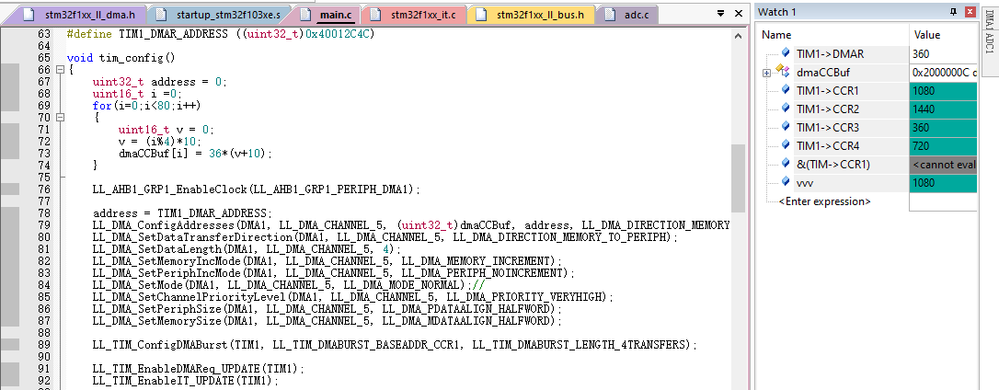

I use tim dma burst to update CCRx(x=1\2\3\4),my code works,but the CCRx value not assigned in correct sequence. My purpose is to let CCR1= 360�?CCR2= 720�?CCR3=1080.
But the result are random.TIM and DMA config codes

2021-04-26 10:26 PM
Don't observe TIMx_DMAR in debugger. Debugger is intrusive and reading DMAR in it advanced the internal counter/pointer to the individual TIM registers.
2021-04-26 10:26 PM
2021-04-26 10:36 PM
Oh,Thanks very much. you are right! This program run ok!
