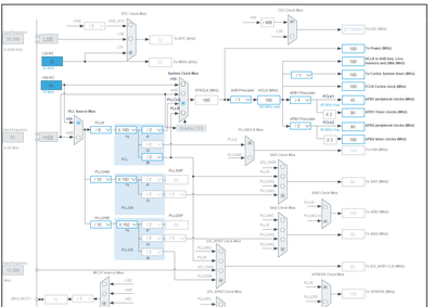

There is UART BUG on STM32F446RCT6
‎2024-01-20 3:22 AM - edited ‎2024-01-22 9:44 AM
STM32CUBEIDE: version 1.14.1
PA0-WKUP ------> UART4_TX
PA1 ------> UART4_RX
On a new project when enabling the UART4 with interrupt on receive ,everything is working normal .
But once I enable PH1 pin as a GPIO_OUTPUT the UART is not transmitting or receiving any more.
Any ideas or help please?
Update 1: I attached the two code form comparing.
Update 2: if I configure the PH1 pin as input the UART4 will work normal
Solved! Go to Solution.

‎2024-01-20 4:15 AM
Dear @Mugtaba ,
PH0 and PH1 are used by the HSE - High speed crystal oscillator for precise clock and get right UART baudrate , if PH1 is configured as GPIO , the system will run on internal HSI and your UART baudrate will be lost and so stopping at application level . Can you check your clocks ?
Cheers,
STOne-32
‎2024-01-20 4:20 AM - edited ‎2024-01-20 4:22 AM
Thank you for your reply
but the HSE is already disabled, I am using the internal clocks
‎2024-01-20 4:25 AM
Interesting ! And what is your UART4 baudrate ? We need to replicated such behavior never seen before .
Cheers,
STOne-32
‎2024-01-20 4:26 AM - edited ‎2024-01-20 5:55 AM
I tested it starting from 9600, 115200 to 512000
