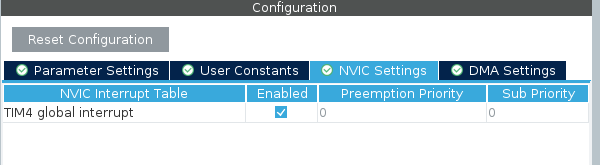

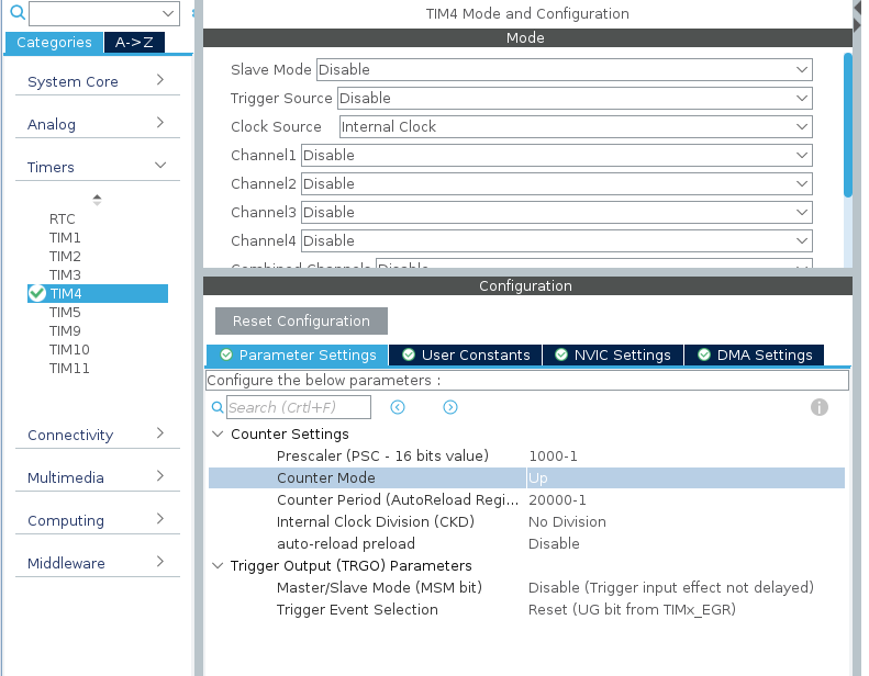

That's how it looks:
  • Started the TIM4 interrupt mode:
/* USER CODE BEGIN 2 */
  HAL_TIM_Base_Start_IT(&htim4);
  /* USER CODE END 2 */
  • The counter values should be incremented in the middle and in the end of the period, however it doesn't happen. There is a problem with the HAL_TIM_PeriodElapsedHalfCpltCallback function. The half_elapsed variable is not inctemented during debugging.
/* USER CODE BEGIN 4 */
void HAL_TIM_PeriodElapsedHalfCpltCallback(TIM_HandleTypeDef *htim)
	half_elapsed++;
void HAL_TIM_PeriodElapsedCallback(TIM_HandleTypeDef *htim)
	elapsed++;
/* USER CODE END 4 */
  • These are my Cube settings:
8 REPLIES 8
HAL_TIM_PeriodElapsedHalfCpltCallback is not called in most scenarios, including this one. It's used during certain DMA transfers and is called when the DMA's HT interrupt kicks off.
Despite the name, and despite the poor documentation of this function, there is no timer interrupt option for half of the period elapsed.
ComandanteChi
Thank you very much, TDK. :smiling_face_with_smiling_eyes: I will find another sotution then.

The previously mentioned callback is for half of the DMA items. If you need half of the timer period, just use an output compare channel to toggle a pin and/or get an interrupt.
