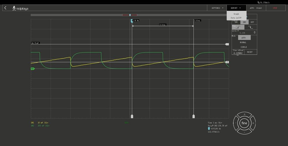

kylongmu
Posted on October 06, 2016 at 06:24
Change the output signal self revert, see the waveform attached.
void DMA1_Stream6_IRQHandler(void)////DAC DMA DMA1_Stream6
/* USER CODE BEGIN DMA2_Stream2_IRQn 0 */
if(__HAL_DMA_GET_IT_SOURCE(&DMA_DAC_Handle, DMA_IT_HT)) { //Half transfer
Dac_Event = !Dac_Event;
HAL_DMA_IRQHandler(&DMA_DAC_Handle);
return;
if(__HAL_DMA_GET_IT_SOURCE(&DMA_DAC_Handle, DMA_IT_TC)) { //Full transfer not enter
Dac_Event = 0;
Yellow channel is the DAC output a SAW UP waveform,
Green channel is the DMA interrupt test output waveform.

Posted on October 06, 2016 at 14:18
Perhaps you should focus on how you are configuring it rather than the interrupt handlers?
kylongmu
Posted on October 07, 2016 at 04:25
You are right, my ADC DMA work with normal mode, it's means 1 transfer to end, but my DAC DMA work with circula mode.
But the interrupt response is still strange, the DAC DMA produce twice interrupt, and it's Flag always shows half transfer.
Whatever, I can initial a global varible to identify if the interrupt is half or full.
