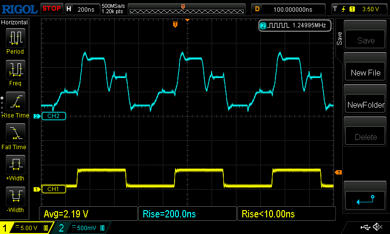

I have a project using stm32G474 nucleo board. The idea is "upconvter" sampling rate of the internal 4 fast - 15 msps DAC using OPAs with input MUX switching. So, 1-st OPA alternatively selects outputs of two DAC's - everything is driven synchronously by Timers chain network. 2-nd OPA - another pair of DACs. And last OPA selects output opa-1 or opa-2 . Switching glitches stop me from developing this into practical design.
Here is a picture:
‎2022-05-07 8:29 AM
Awesome data! Thank you for making time to share it and explain what you did and the issue.
In my application, the opamp is going into the ADC. So, I can adjust the sampling time so that the glitch has settled out.
In your application, I'm guessing you want a sample and hold so that you can use that to sample and hold the opamp output, switch the opamp's mux input, wait for the opamp to settle and then reconnect the sample and hold to pass through the new input.
