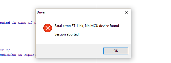

I've used STM32 cube to generate a sample program for both free versions of atollic true studio and IAR for ARM. When trying to program/Debug the board most of the time I get something like this:

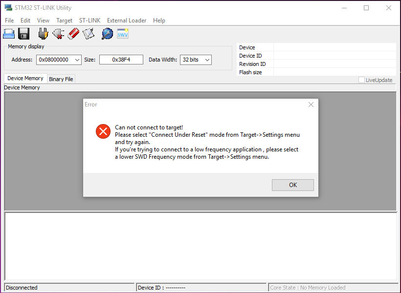

when lucky I'm able to debug some lines of code but if I stop the debug session it won't be possible to resume. Even with the stm32 utility I get this:
I've measured the voltages on the board they are ok! when connected to USB the drive appears and downloading a .bin from mbed site works.
So, I ask you, what does it look like? Sw problem or damaged board?

Did you use sleep modes?  I check SWD in CUBE.??

On Cube I've selected this evaluation board and the pins for SWD are already selected. I have no sleep modes not intentional at least.

Does using ''Connect Under Reset'' help? How about strapping BOOT0 High?
Low power, WFI loops, reprogramming JTAG/SWD pin functionality...
