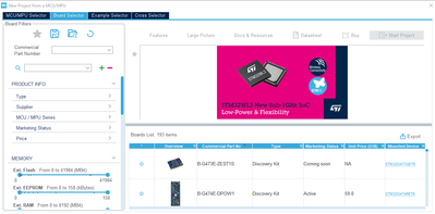

I suggest you to use the MCU/MPU filters of CubeMX to make a choice about whish product will be the best for your needs:
Also, you can take a look at the available board for each MCU series looking at the Board Selector of CubeMX:
Best Regards.
Best Regards.
