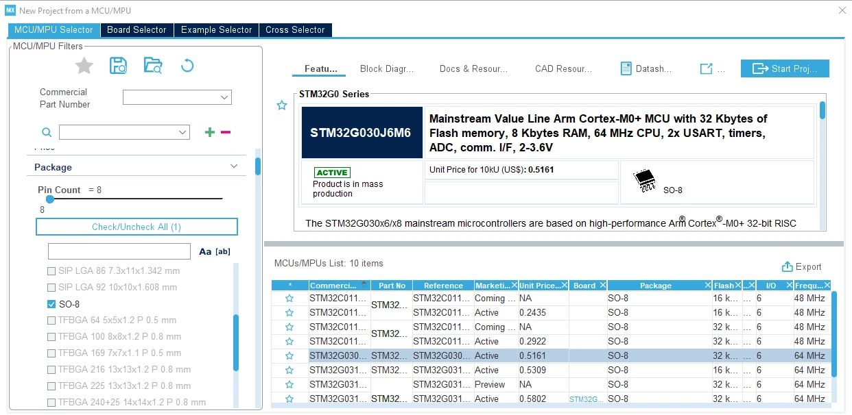

I am quite conversant with STM32F401, 411, L476 etc.
I am looking for a tiny 8-pin MCU that will have 1 analog input and 2 or 3  digital outputs. If 8-pin is not available in 20 pin TSSOP package will do.
I request the users to help me with selecting a low-end 32-bit MCU. major requirements are:
1. The cost should be small.
2. The power consumption is not important and many other features are not required.
3. I was thinking of using something small device such as  STM32G030x6/x8 that comes in SO8N & TSSOP package.

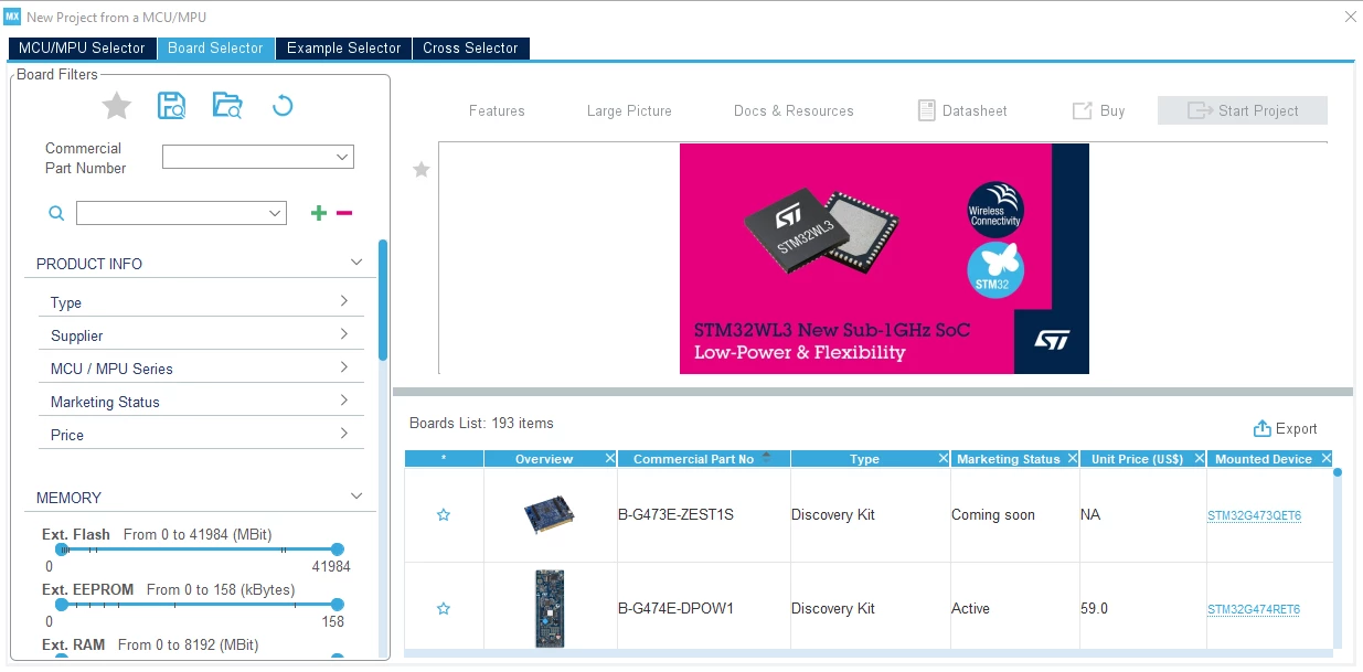

4. From a software developer's point of view, it would be nice, if it has got an evaluation board such as Nucleo or Discovery or Bluepill, for fast development.
5. Should be easy to program/flash in mass prduction.
6. I do not wish to use 8-bit or 16-bit MCUs for this application.
Thanks to all.
Best answer by STTwo-32
Hello @prakashdandekar and welcome to the ST Community :smiling_face_with_smiling_eyes:.
I suggest you to use the MCU/MPU filters of CubeMX to make a choice about whish product will be the best for your needs:
Also, you can take a look at the available board for each MCU series looking at the Board Selector of CubeMX:
Best Regards.
STTwo-32
Best Regards.
STTwo-32
