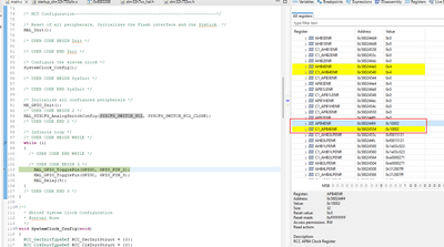

During our development process, we encountered an issue with using PC2_C to control SPI2 (SPI2_MISO), where it consistently pulls low. Despite extensive debugging efforts, including configuring the pin as GPIO and measuring with a logic analyzer, the issue persisted. Upon researching similar cases on the ST Community forum STM32H735V (LQFP100) PC2_C and PC3_C speed and FAQ: Default State of STM32H7 switches connecting Pxy_C and Pxy pads, we realized it might be related to a known issue in the STM32H7 family, specifically a bug in the silicon regarding the PC02 pin.
After reviewing the documentation and conducting tests on our end, we observed that while PC3_C can be controlled as expected, PC2_C cannot be controlled even when manipulating the external pad switches using the provided code:
HAL_SYSCFG_AnalogSwitchConfig(SYSCFG_SWITCH_PC2, SYSCFG_SWITCH_PC2_CLOSE);
HAL_SYSCFG_AnalogSwitchConfig(SYSCFG_SWITCH_PC3, SYSCFG_SWITCH_PC3_CLOSE);

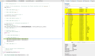

Hi @Andreas Bolsch , here are the values of these registers (0x580244F4, 0x58024554, and 0x58000404) after call:
Hm, these value are indeed correct. So the problem must be in hardware. Revision 'V'?

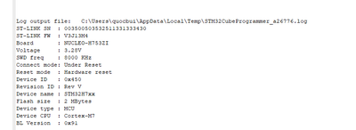

QuocBui
Hi @Andreas Bolsch, FYI, here is the chip information on NUCLEO-H753ZI Dev-Kit:
  • As I've already suggested, you need to check the continuity.
  • You need to confirm if PC2_C was not previously used and therefore broken.
PS: there is no difference between different silicon revisions in term of PC2_C pin.
