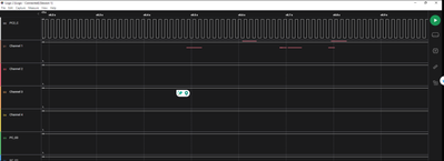

During our development process, we encountered an issue with using PC2_C to control SPI2 (SPI2_MISO), where it consistently pulls low. Despite extensive debugging efforts, including configuring the pin as GPIO and measuring with a logic analyzer, the issue persisted. Upon researching similar cases on the ST Community forum STM32H735V (LQFP100) PC2_C and PC3_C speed and FAQ: Default State of STM32H7 switches connecting Pxy_C and Pxy pads, we realized it might be related to a known issue in the STM32H7 family, specifically a bug in the silicon regarding the PC02 pin.
After reviewing the documentation and conducting tests on our end, we observed that while PC3_C can be controlled as expected, PC2_C cannot be controlled even when manipulating the external pad switches using the provided code:

Hi @mƎALLEm , I have just tested the code that you provided on the NUCLEO-H743ZI Dev-Kit on PC2_C Pin, and it worked as expected (toggled as I anticipated).
However, for the NUCLEO-H753ZI, it does not work; similar to the issue I reported to you.
There is an issue with that chip and the IO is defective. You need to replace the chip. As I said H743 and H753 are the same die so it’s not a silicon issue.
Hi @mƎALLEm , I tried two NUCLEO-H753ZI Dev-Kits, and the issue persists. Do you think there might be a problem with the IO during the manufacturing of the Dev-Kit?

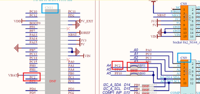

On which connector are you probing PC2_C pin? CN9 or CN11?
If on PC9, what about the SB53 solder bridge? is it soldered?
Could be better to check the continuity between the MCU pin (pin 28) and the connector pin to be sure the HW doesn't present an issue.
Hi @mƎALLEm , I attached a probe to CN11 (PC2), soldered the header, and measured the signal there.
