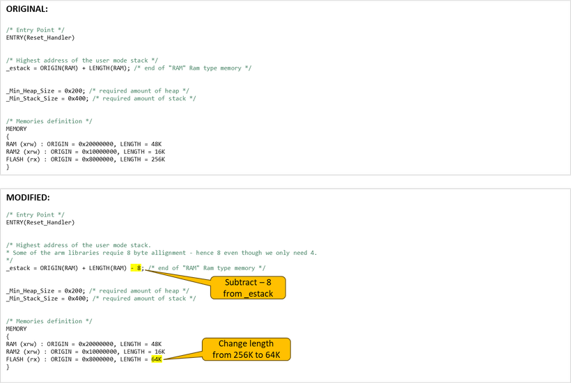

I have written a custom bootloader that is running on a Nucleo-L433RC-P board.
The application uses USB CDC to call the bootloader and the bootloader uses USB DFU to download the application.
I wanted to use USB to call the custom bootloader, rather than having to use a physical switch on the BOOT0 pin to call the internal bootloader
I can successfully download a simple application which just flashes an LED using the USB DFU bootloader.
However, when I download my actual project, it appears to download successfully but does not run.

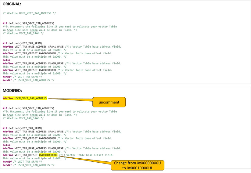

The implementation is shown below.

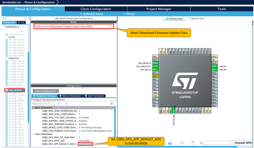

Bootloader USB configuration...
Changes to bootloader linker script...
Bootloader main.c...

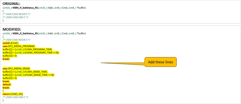

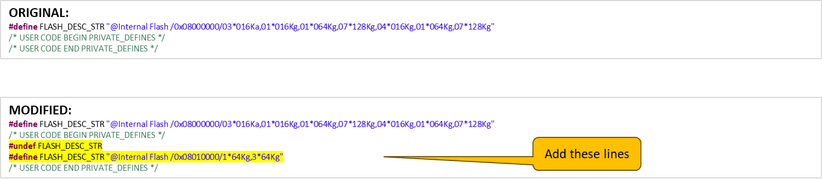

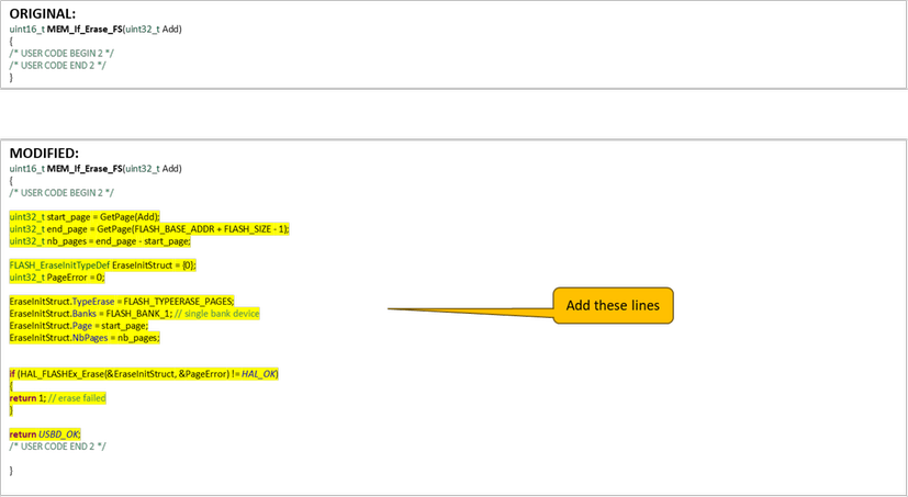

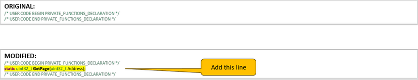

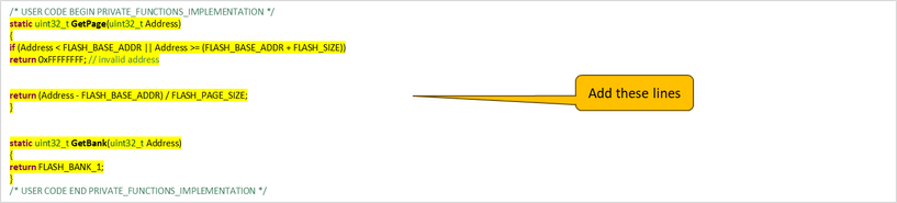

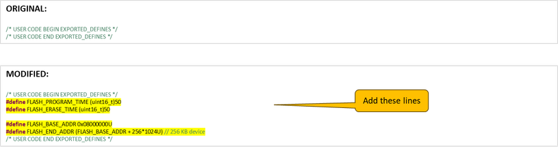

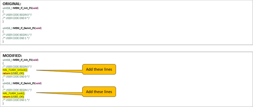

Changes to bootloader usbd_dfu_if.c....
Changes to bootloader usbd_dfu_if.h....

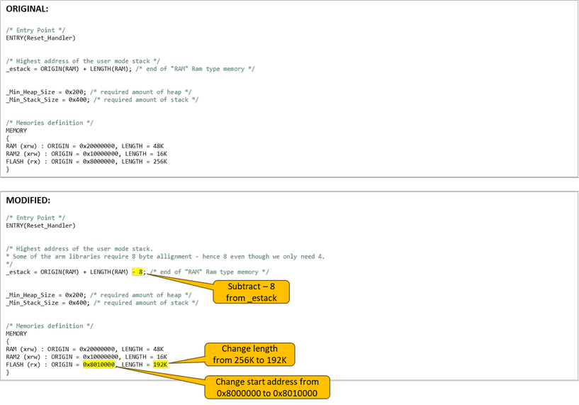

Changes to application linker script...

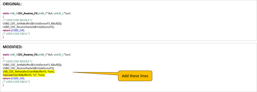

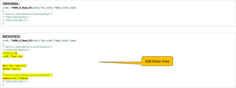

Changes to application system_stm32l4xx.c...
Changes to application usbd_cdc_if.c...

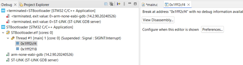

However, when the bootloader is called the computer does not see the USB DFU device.
If I pause the debugger, it shows the following...
My code is below...
