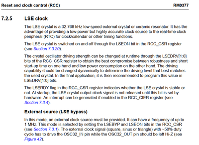

Just to be sure: The LSE crystal is already implemented inside the microcontroller, isn’t it? I didn’t put any additional components to the setup. There is no "crystal arrangement".
In RM0377 chapter 7.2.5 I read:
“The LSE crystal is a 32.768 kHz low speed external crystal or ceramic resonator. It has the advantage of providing a low-power but highly accurate clock source to the real-time clock peripheral (RTC) for clock/calendar or other timing functions.”
Furthermore, in chapter 7.2:
“The devices have two secondary clock sources:
• 37 kHz low speed internal RC (LSI RC) which drives the independent watchdog and optionally the RTC used for Auto-wakeup from Stop/Standby mode and the LPTIMER.
• 32.768 kHz low speed external crystal (LSE crystal) which optionally drives the realtime clock (RTCCLK), the LPTIMER and USARTs.”
I would like to use the LSE for timing functions and I read it has a high accuracy (typically a few tens of ppm’s). Attached please find the schematic of the pcb. Removing the ST LINK V2 (breakout from a NUCLEO board) and adding a battery as power supply to the breadboard, the timer is not working/starting at all. Same as for my pcb's.
The LSE (low speed external) crystal is not inside the MCU. You need to add one externally.
Hi TDK,
If this is the case, why is the Reference Manual talking about a special mode using a separate external source (LSE bypass)? I thought this mode is used to add an external clock source of up to 1 MHz. And if you dont use the bypass mode you can use the internal LSE crystal which is specified to be 32,768 kHz. Could you please confirm once again that I interpret the RM wrong?
waclawek.jan
The wording of RM may be not the perfect, and you are not the first to misunderstand it.
You have two options to use LSE:
- connect externally a 32.768kHz crystal (known sometimes also as "watch crystal"), or
- connect externally a 32.768kHz oscillator, when you set the LSEBYP bit (to avoid using the internal amplifier which would be used otherwise as part of the oscillator together with external crystal)
As TDK said above, there's no crystal built into the chip.
