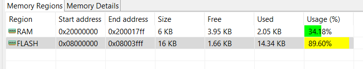

Hi, I would like to know method and sample code storing data without erasing whole memory page. I do refer example FLASH_EraseProgram, but i have wrote program that almost finish up the flash memory, if i erase a page, a 2KB page, it will erase my code map, and cause the program hardfault, the MCU i use is STM32C0 with 16KB flash. So, may i have some info to solve it? Thanks.

This can be easier than you think)) If you use the CubeIDE debugger to load the program, (by default) it won't fill the unused end of the last page. So you can just write there without erase. Just mind the needed alignment: 8 bytes (64-bit). Also note that STM32C0 has OTP memory, you can use it (program only once, of course).
hi,
i try to write data to 0x8003C00, if erase a single page 7 of the memory block which start with 0x08003800, then it will erase my code which end in 0x080039A0. It might more challenging to me as a beginner.image.png
