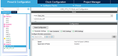

hi all and
@Lubos KOUDELKA
USB - HID -Keyboard is working fine and keycode coming properly .
Enter to STOP mode is successful by HAL_SuspendTick()HAL_PWR_EnterSTOPMode(PWR_LOWPOWERREGULATOR_ON, PWR_STOPENTRY_WFI);
Trying to wakeup from usb keyboard and couldn't catch the callback for adding this  SystemClock_Config (); HAL_ResumeTick(); . what is the exact callback name and where is it

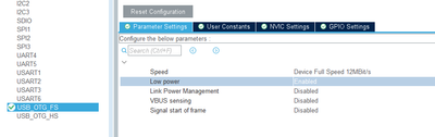

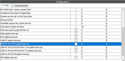

checking in STM32CubeMX, to have in NVIC table OTG wake-up EXTI line available
You need to allow "Low power" in parameter setting of your USB_OTG_xS device setting
Please check this setting and already existing USB examples in F4 family repository, which will guide you which code you need to add.

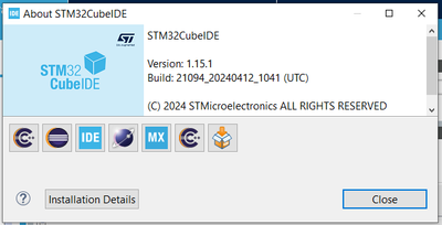

cube ide current version
There is no low power option ? .

Lubos KOUDELKA

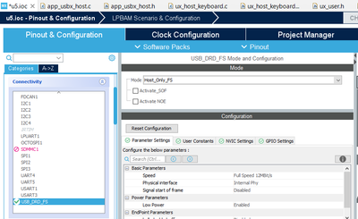

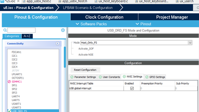

I see in your configuration Host_only mode. USB suspend is available only for USB device in STM32CubeMX, I also don't see any example showing USB host suspend, as it's very rarely requested.

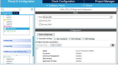

Device_Only Mode having low power option !!!!!!!  but as you said Host_Only  mode is suspend the low power option . even i have with checked Cube Mx separately and they also behave same condition .
Kind Request : can you please confirm me HOST + HID low power option is there or not ? and HOST + HID STOP mode  wakeup is possible or not ?.
Lubos KOUDELKA
In OTG_xS peripheral hardware there is support for both USB host or device with low power support for both modes. But in STM32CubeMX configuration or library example only USB device low power support is covered. So you can manage also USB host low power functionality, but more coding effort is required.

G Series ,H5 series, L5 Series , U5 Series  controller having low power option in host mode but there is NO USB wake up  interrupt call . these controller having Type C option as per cubemx .
