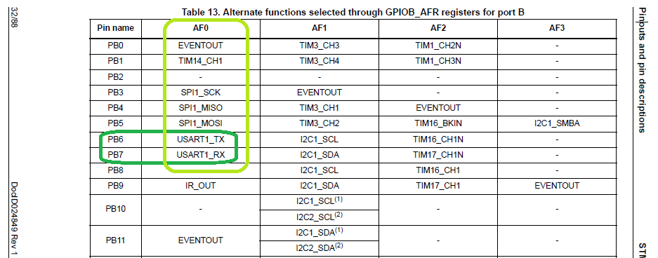

Posted on April 07, 2014 at 16:07
Try GPIO_AF_0 for PB6/PB7
Good call laurent
Something that would have been caught by observing the pin, and reviewing the manual for the part.

Posted on April 08, 2014 at 07:58
HI
Thanks for your support . To check I have implemented the code in the same board for stm32f030R8t6.connect by wire PB6 tx and p7 as rx in stm32f030r8t6. I get to know that data is getting transmitted . but RXNE bit is never getting set. I write the glowing LED line to check whether it is entering or not but it's not . So the problem is in RXNE bit.what may be the problem.

Posted on April 08, 2014 at 08:31
Have you observed any of the signals with a scope?
What if you generate a serial stream from somewhere else, and feed it into the USART1_RX (PB7)? Does it receive then? What if you create a small receive only test app? How about toggling PB7 as a GPIO, and confirming you're looking at the right pin?

Posted on April 08, 2014 at 09:38
sorry clive the data is not sending too . I have checked witg the help of hyper terminal(docklight) connected with the PC .. It is not sending  in the hyperterminal . but I am not getting in the main in the below line
while ((uart1TxIndex < BufferSize) && (uart1RxIndex < BufferSize));
then why the uart1Index is getting increment 7 in this case as AAAAAAA data i am sending.
Really I am not understanding where the configuration got wrong really?

Posted on April 08, 2014 at 09:46
What about looking at the signals with a SCOPE, your project involves signal analysis, you've got to have a SCOPE, USE IT!!!
If USART still doesn't seem to work go back to first principles, I've posted a bunch of USART example code.
