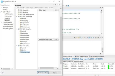

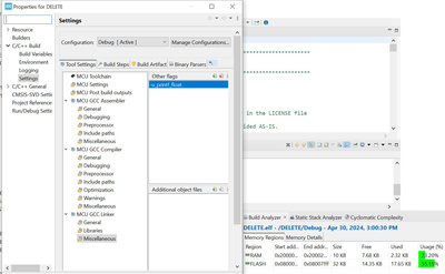

I am having stm32F103C6T6 Development Board. When i enable -u_printf_float flag for Float printing on 16x2 LCD it takes upto 15KB of total space .
Please guide. what else can be done ?
-u_printf_float Enabled :
Without Flag for Float

The stm32F103C6T6 has no hardware floating point, so it all has to be done in software - which uses up flash space.
Don't use floating point!

Try to set compiler optimization for code space.
Not sure how much that will help, as the software floating point and the printf stuff are in binary libraries...

Could you convert and break down the float values into integer sub-components that you could print with the classic integer formatting methods. ie "%d.%03u"
Things like dtoa() are quite heavy, probably a large portion of the cost here.
As Andrew said, the ideal situation might be to not use floating-point. Can your number ranges be accommodated by a fixed point solution using integers?

If floating point can be removed that would save the most space. Say an appropriately chosen fixed point or scaled integer?
