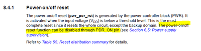

I don't understand the goal of pin PDR_ON.
From STM32H7 reference manual:
I don't understand what "the power on/off reset function can be disabled" means. The product does not go to reset state even if the voltage goes below PDR threshold ?

Hi @Gpeti
The function of PDR_ON pin is to enable/disable the internal power supervisor (power-on reset (POR) / power-down reset (PDR) circuitry).
- Pin PDR_ON = VDD, the internal power supervisor is enabled, if VDD goes below a specified threshold, the device is placed in reset mode.
- Pin PDR_ON = VSS , the internal power supervisor is disabled and the user should implement an external power supply monitor for VDD and NRST.
You can refer to AN4938 in section 2.3.5 and 2.3.6.
