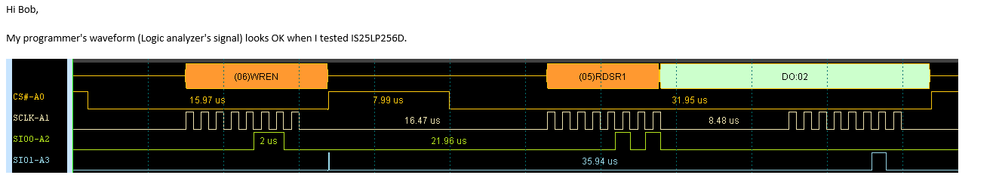

Below is a screen shot from the FAE for ISSI who mentioned a 8us delay was needed.
0693W00000LxrcKQAR.pngI'll go read the responses closer. I guess what I need is the ability to:
1) Pull /CS low
2) Send a 8 bit command (0x05).
3) delay ~8.48uSec
4) send 8 clock pulses and read the returned value.
5) release /CS
Any ideas?
thanks,
Bob
ps Note there is first a WREN command given, I don't see how this would impact anything but I'll go try adding that command and delay.
This looks suspicious: no clocks during the 8us delay contradicts to the ST document on QSPI interface.
Such delay is only possible at slower clock rate (more than 8 us between pulses).
Normally, delays are implemented with dummy clock cycles, and number of the cycles is documented.
[CORRECTION]
For the command 05 the number of dummy cycles is probably the "default" number in footnote of table 6.11 (page 22), which is indeed 6 for QPI mode and 8 for SPI mode.
It's not clear whether this applies to read register commands. But worth to try. 6 or 8 dummy cycles, or none at slower clock rate.

The screenshot of the LAX was provided by the ISSI FAE, so I can't generate other shots. (The problem was sending WREN and the SR would return 0x04 instead of 0x02. The problem went away with the delay recommended.)
Is it possible to add the delay using the existing HAL library and I can run tests on my end?
Otherwise I'm going to look into writing code that does a simple bit-bang to get the SR to respond correctly.
