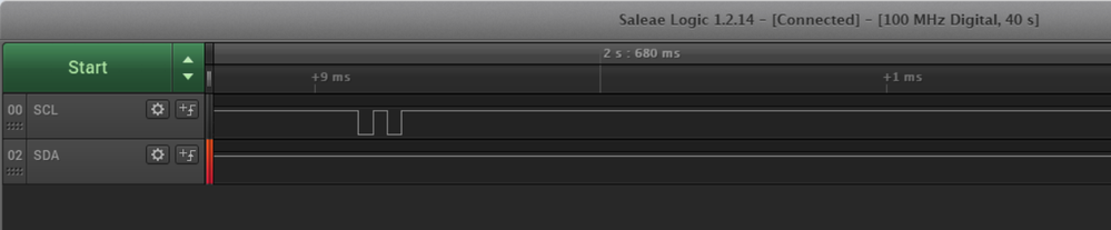

I'm trying to add I2C1 in "controller mode" to an existing STM32U5G9 project, but am struggling to get it working.
I am setting up the peripheral using HAL/LL calls and not relying on CubeMX setup.
# What I'm Seeing
The goal is to have PG13 = SDA and PG14 = SCL with an I2C clock rate of 10kHz.  On those pins, I see no activity even though my firmware should attempt an I2C transaction after initializing the peripheral.  The two I2C pins just stay HIGH all the time.  (I have 4.7kOhm external pullups.)
If I switch SCL to PB8, I do see some activity but it looks wrong (not enough clock pulses for SCL):
For the ~2 clock pulses on SCL here ^, the timing is correct (~10kHz), but I'm not sure why it stops and doesn't do a full 8 clock pulses...
Port G needs to be enabled:
HAL_PWREx_EnableVddIO2();
How are you using the I2C? I see initialization but not usage. Do the functions return HAL_OK?

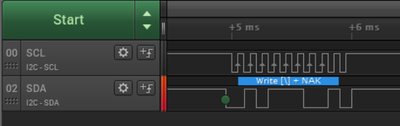

Wow, thanks TDK.  Seems like it was just that 1 missing HAL_PWREx_EnableVddIO2() function call to get it working on port G pins:
^ This is via a call to HAL_I2C_Mem_Read() after initialization now.  Still need to figure out why the target device isn't responding, but at least the STM32 is doing the correct thing.
Note that 7-bit slave addresses should be shifted left by one bit. What are you trying to interface to?
