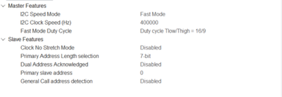

I2C Configuration:

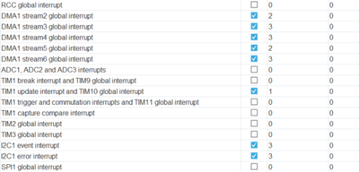

NVIC Configuration:
Only TIM1 update interrupt (TIM10 not used), DMA1 stream2 (SPI3_RX) and DMA1 stream5 (SPI3_TX) have higher priority than I2C1.

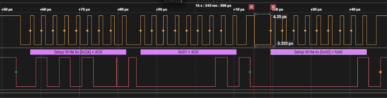

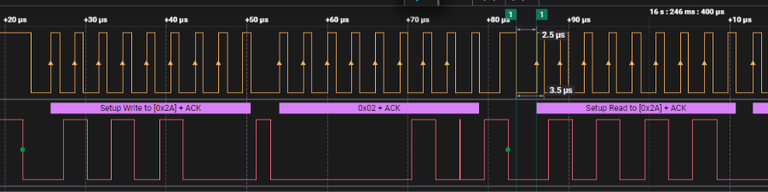

Here is an example of a correct signal:
The signal with error and I2C_Flush_DR() looks like this:

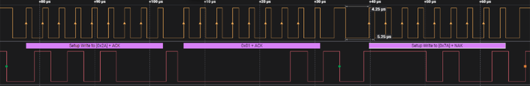

The signal and I2C_Flush_DR() looks like this:
static void I2C_Flush_DR(I2C_HandleTypeDef *hi2c)
  /* Write a dummy data in DR to clear TXE flag */
  if (__HAL_I2C_GET_FLAG(hi2c, I2C_FLAG_TXE) != RESET)
    hi2c->Instance->DR = 0xF4U;
 As you can see, this happens because I2C_Flush_DR() is called at the wrong time, but I don't know why. The slave address should be written to the DR register, but the value from I2C_Flush_DR() is written instead.

The I2C peripheral on the STM32F4 has some unfortunate race conditions that must be met to succeed. It would not surprise me if one of these was failing due to the presence of other code.
Can you set the I2C interrupt priority to above all others and retest?

The error appeared irregularly, every few minutes, sometimes more often. I ran test with a higher priority (~6 hours) and the error did not occur, but I don't know if it's gone or if it hasn't appeared yet. So it's possible that this is the solution.
