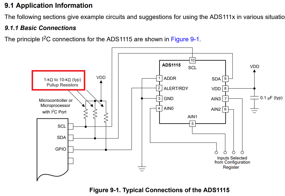

Your issue is more related to the external ADC ADS1115 which is not ST product.
You said:
  • Pull-ups initially were 12 kΩ to 5 V
But in the ADS1115 datasheet. the range is 1K to 10K:

He's using an external ADC chip (ADS1115 over I2C) from TI. I've already modified the title to make it clear.
@mƎALLEm i gues you have misread my issue.
External ADCs are working fine and I Can read all 3*4 = 12 channels.
The Issue i am facing is with internatial ADC specifically from CH0 to CH13.
(For testing i have enabled all adc pins  )
@Ozone internal ADC are never seeing 5v as there is a voltage divider on pressure sensor pins.
And those are the channels i am facing issue.
Attaching related schematics for your reference.
