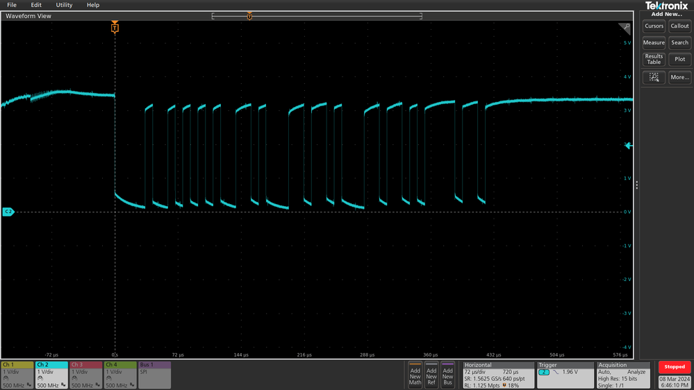

I have been using stm32u585QII3 MCU in our custom board. I am using USART1(PB6, PG10) to transmit and receive data. In interrupt mode transmit call back is working but receive call back was not working. Initially i have set a break point, the interrupt hits one time in debug mode, then when i try to send data, the interrupt is not hitting. I have tried this in polling method too, and it was not working. I have attached scope images of both  transmit and receive. In which the signals is being transmitted but not received by the controller.

Looks like your TX signal goes to something external and that something external sends a signal back on RX. Correct?

Looking at your waveform which doesn't look clean, maybe you have a noise error or framing error? Or did you not ground your probe?
