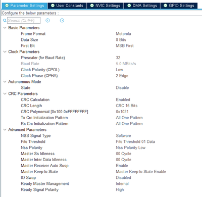

I am currently trying to enable the CRC SPI (CRC-16/CCITT-FALSE) on my project, but I can't make it work.
You can found bellow the SPI configuration set on CubeMx
Here is the message read back on my logic analyser, in yellow (0x0C52) you'll found the CRC computed by the uC.
However with the configuration set I am expecting to get this value: 0xE1F0

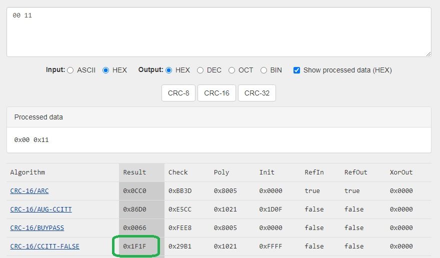

What would be far more helpful would be the output code, and the registers, especially the CRC register, as you output each of the bytes.
A quick C coding got me 0x1F1F, so no idea where you pulled any of your numbers or expectations.
An for extra entertainment, I ran it thru crccalc.com

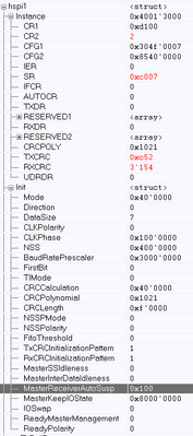

First what do you mean by "the output code" ? If you refering to the code error send from the HAL_SPI_TransmitReceive command this one is currently HAL_ERROR with the CRC error code fault.

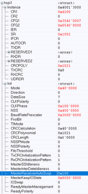

Concerning the SPI register this is the register before the transmission
and bellow the SPI register right after the transmission

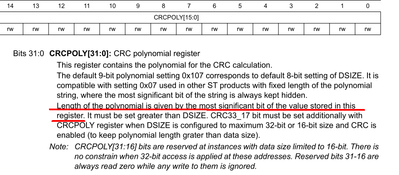

Okay, the 'U5 SPI is yet again more complicated, and the documentation is... well... "ST-style". I faintly recall @Uwe Bonnes writing about it recently. And okay, I see, while there's no way to set an arbitrary initialization value, there's a new TCRCINI bit which allows to set the "all ones" as alternative to "all zeros".
And then there's also this:
