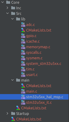

2023-09-11 7:46 PM - edited 2023-09-11 8:02 PM
For me, this was also indirectly my issue.
At first it seemed it wasn't my issue, since I had a call to __HAL_RCC_PWR_CLK_ENABLE() in my HAL_MspInit() function:
/* USER CODE END 0 */
* Initializes the Global MSP.
void HAL_MspInit(void)
/* USER CODE BEGIN MspInit 0 */
/* USER CODE END MspInit 0 */
__HAL_RCC_PWR_CLK_ENABLE(); // <---- Already here!
HAL_PWREx_EnableVddA();
/* System interrupt init*/
/** Enable the VREF clock
__HAL_RCC_VREF_CLK_ENABLE();
However, forcing a call to __HAL_RCC_PWR_CLK_ENABLE() in my main() function before calling HAL_PWREx_ControlVoltageScaling(PWR_REGULATOR_VOLTAGE_SCALE1) fixed the issue:
void SystemClock_Config(void)
__HAL_RCC_PWR_CLK_ENABLE(); // <---- Force add a call here in my main.c
if (HAL_PWREx_ControlVoltageScaling(PWR_REGULATOR_VOLTAGE_SCALE1) != HAL_OK)
Error_Handler();
So clearly my HAL_MspInit() function wasn't being called, otherwise this fix wouldn't help.
I can see from grepping my Cube generated code and the HAL library code that HAL_MspInit() is not explicitly called by my Cube generated code, but rather as a weakly declared function called by the HAL -- that is, the HAL will call it if it's defined, but won't care if it's not defined and will continue on as if nothing is wrong.
So... finally putting the pieces together, I realized I must not actually be compiling the stm32u5xx_hal_msp.c code file -- the file where HAL_MspInit() is defined, by my Cube generated code. I know it's in the list of files to be compiled, however... Indeed, I see that I had it compiled as part of the library target I created, rather than the main executable target. Moving it to the main executable target fixed the issue!
Note that I ported the Cube generated code to Cmake using https://github.com/ObKo/stm32-cmake to help package the HAL and CMSIS into proper Cmake targets. Putting the stm32u5xx_hal_msp.c in the wrong Cmake target was my mistake when doing the port.
