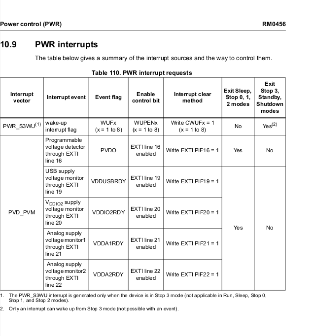

I am developing an application for the STM32U575, and am currently testing on the Nucleo-U575ZI-Q. As per the reference manual (Rev. 4) Section 10.9 PWR Interrupts, Table 110 Note 1: "The PWR_S3WU interrupt is generated only when the device is in Stop 3 mode (not applicable in Run, Sleep, Stop 0, Stop 1, and Stop 2 modes)."
However this is not the behaviour I am observing. I have found that the PWR_S3WU interrupt is generated whenever the Stop 3 mode is configured as the Deep Sleep Mode (i.e. PWR_CR1 LPMS[2:0] = 0b011), even if the stop mode is never entered.
Can I please get confirmation what behaviour I can expect, for the nucleo and my target hardware (STM32U575VIT6Q)

Hi @r-drage,
It seems that the note below in the RefMan RM0456 is wrong:
1. The PWR_S3WU interrupt is generated only when the device is in Stop 3 mode (not applicable in Run, Sleep, Stop 0, Stop 1, and Stop 2 modes).
We are updating the note as below:
1. The PWR_S3WU interrupt is generated only when STOP3 mode is selected (LPMS=011 in PWR_CR1 register, not applicable in Run, Sleep, Stop 0, Stop 1, and Stop 2 modes)
As a SW workaround, you can push this activation only just before entering STOP3 mode.
Can you please try this change to your application and please keep me updated on this.
Thanks
Imen

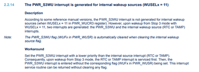

This can be caused by the limitation detailed in the STM32U575 errata sheet.
2.2.14 The PWR_S3WU interrupt is generated for internal wakeup sources (WUSELx = 11)
Thanks
Imen
r-drage
Hi Imen, thanks for your response and the welcome :grinning_face:
I had read that note in the errata and did not think it applied to my case - I should have specified but the WU selections I have made are external pins. (WUSELx != b11)
